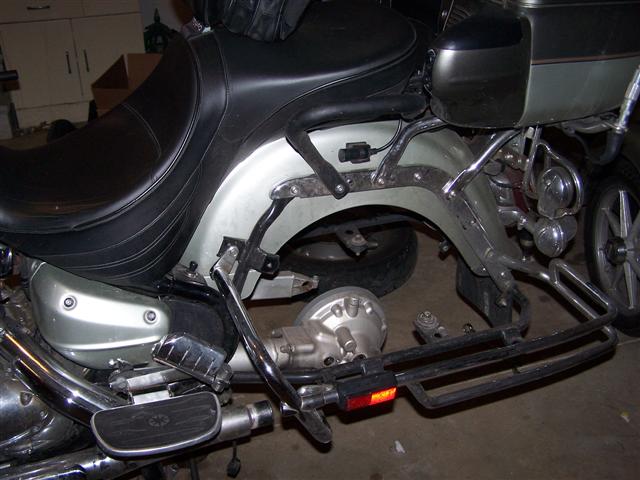

Since there are already instructions posted for removing the rear wheel, I will start this procedure at the point where the saddle bags, rear wheels and mufflers have already been removed.
So here we are at that point.

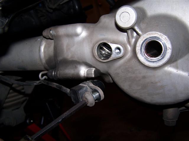

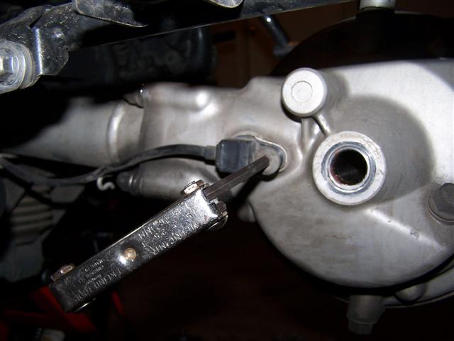

Remove the one screw that secures the speedometer sensor to the rear end.
.jpg)
After the screw is removed, the speedo sensor just pulls out. There is an O-Ring so you have to pull on it fairly hard.

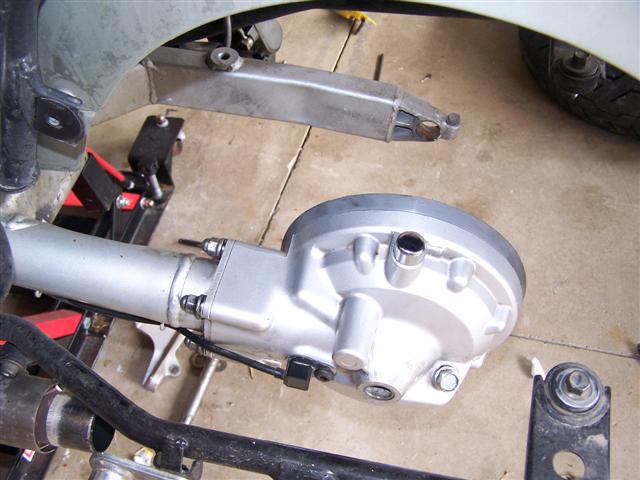

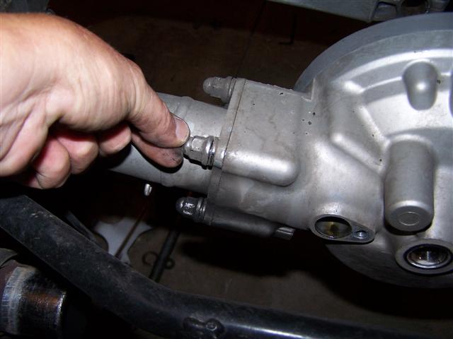

Remove the 4 acorn nuts that secure the rear end to the drive shaft tubes.
.jpg)

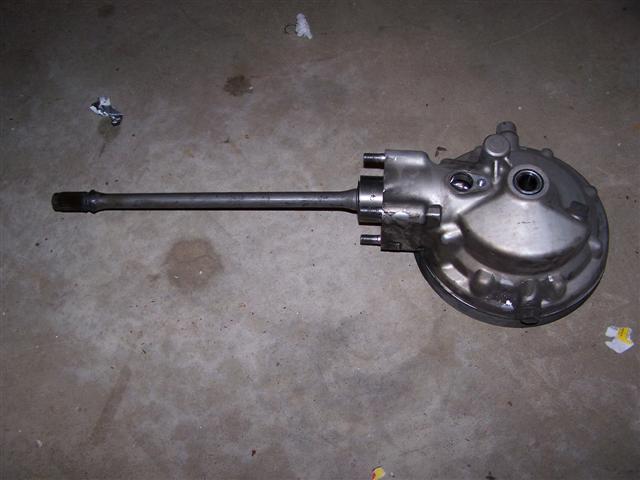

Slide the rear end off. The drive shaft will come out with the rear end.
.jpg)
Here is the assembly removed.
.jpg)

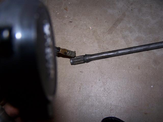

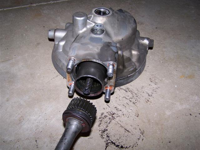

You then need to pull the drive shaft out of the rear end. There is nothing it in except for an 0-Ring so you have to pull on it fairly hard but it will come out.
.jpg)

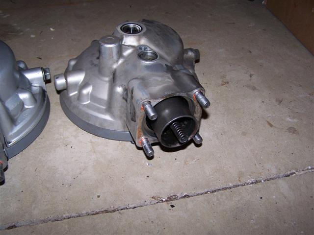

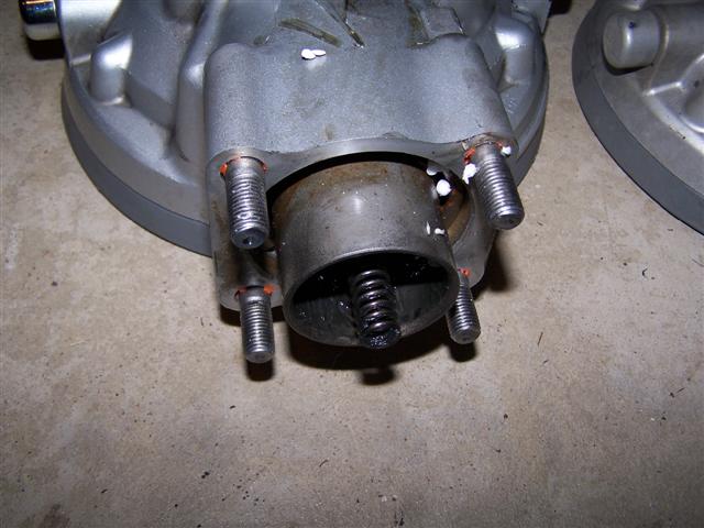

There is a spring inserted in the rear end that you will need to remove and insert into the new rear end. It just pulls off so pull it off and install on the new one.
.jpg)

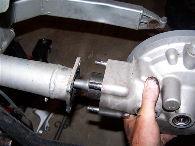

Install the new rear end with drive shaft. Leave the four acorn nuts loose for now.

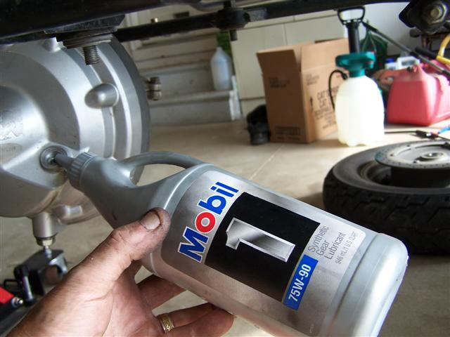

Now you are ready to fill the new rear end with lube. I use Mobil 1 synthetic but that is just my personal choice. As you can see, I filled the rear before re-installing the rear wheel so you can actually do it either way.
