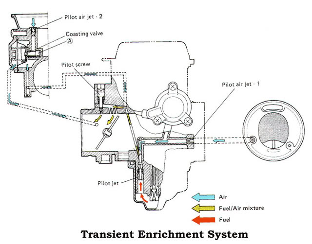

Prairiehammer Posted November 26, 2019 #3 Posted November 26, 2019 jfman said: https://www.venturerider.org/forum/attachment.php?attachmentid=118151 What is the purpose of the little diaphragm on the side of the carb body? What is its correct name (Yamaha parts fiche calls it a diaphragm set) Also if it fails or if the holes leading to it are plugged, what will be the symptoms? Has this part been known to fail on ventures. It is variously called the "coasting enrichment valve" or "air cut-off valve" or "transient enrichment valve". When the throttle is closed, there would a transient lean condition, causing popping upon deceleration (coasting). This device enrichens the circuit to prevent popping. The diaphragm can be damaged by aggressive carb cleaners and the diaphragm can also develop holes. The result will be a vacuum leak and popping. Air Cut-off how it works.docxFetching info...
