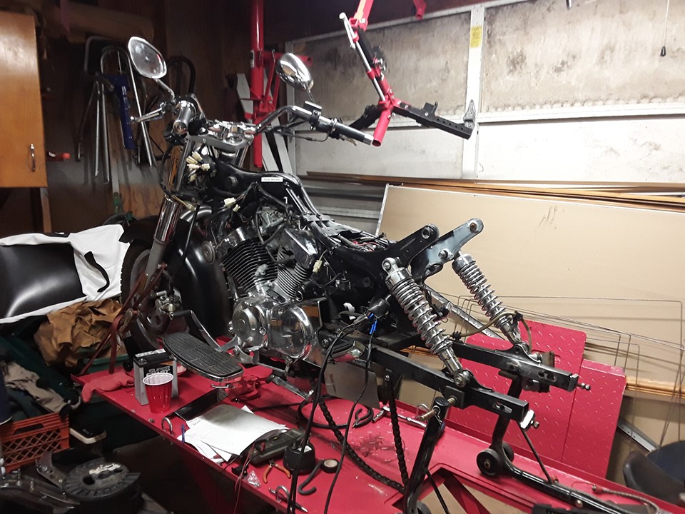

luvmy40 Posted August 5, 2019 Author Share #2 Posted August 5, 2019 I was unexpectedly sent out to Connecticut for a few weeks so Kris is on her own working on her bike. Here's what it looks like today. She's got most of the obstructions stripped away and is working on developing a wiring diagram. We can't find one that is completely accurate anywhere. Before I left, I was able to get the fuel system re-plumbed and the bike fired up and ran as well as could be expected with the exhaust removed. Everything else is really cosmetic at this point. Link to comment Share on other sites More sharing options...

luvmy40 Posted October 6, 2019 Author Share #5 Posted October 6, 2019 No new pics as the little guy still looks exactly like the last pic. We did get a driving light bar, Tomb Stone tail light, rear turn signals, new hand controls, including a clutch perch w/ clutch interlock switch(which was not present originally) and a new front break lever w/MC. Kris is getting the wiring in order and I'm working on modifying the control pods. We could not find controls for 1" bars that had a single indicator switch in the left pod anywhere so I ordered a set for 7/8" bars and machined the "journals" to fit the 1" bars. Now I'm working making the throttle cable fit properly. Now I need to track down caliper rebuild kits for the Honda Rebel calipers and see if Earl will make us up some new brake lines. Then we need to start fixing the tins, most of which are actually plastic and getting them ready for paint. I'm thinking metallic emerald green and cream in a classic FLH two tone scheme. Link to comment Share on other sites More sharing options...
