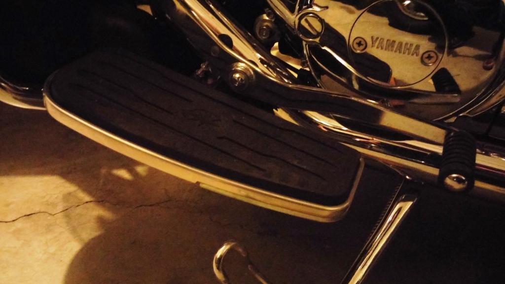

Rasa Posted November 5, 2018 Posted November 5, 2018 I was wondering does the heel part of the shifter sit above the floorboard or behind it? Could you post a picture of it on your bike? Thanks Rasa
Kretz Posted November 5, 2018 Posted November 5, 2018 (edited) I was wondering does the heel part of the shifter sit above the floorboard or behind it? Could you post a picture of it on your bike? Thanks Rasa On my RSTD Definitely both, sits above (about 1-2") & back from the FB about 2" sorry the pic is poor but it's dark in the garage. Edited November 5, 2018 by Kretz

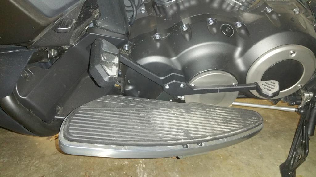

darylbandy Posted November 11, 2018 Posted November 11, 2018 I just got this installed last night. This part should have come stock on such and expensive bike in my opinion.
