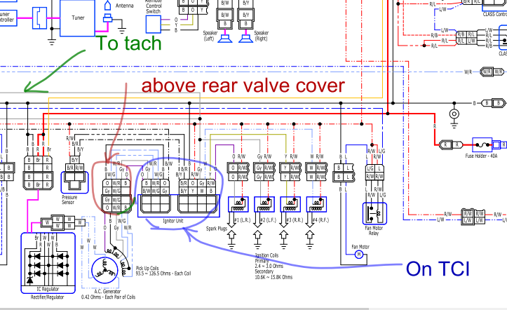

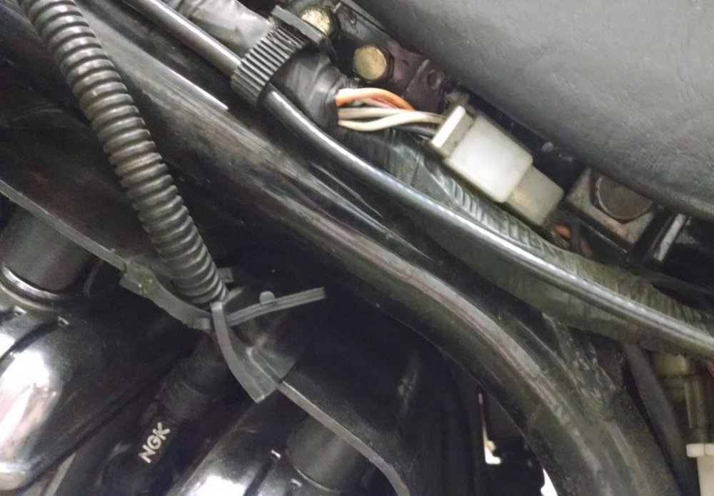

yamagrl Posted May 8, 2016 #3 Posted May 8, 2016 (edited) Clean TCI connections!! I concur. The tach is the dead give away. If I recall there is a quick disconnect tucked in around the area of the fuel pump that contains the five pickup coil wires that come out of the stator cover. These wires go into one side of the TCI. This is where the TCI gets its signal that it processes and sends to the coils. I would tinker with this one first since it's pretty easy to get to. TCI might be bad. I can take a picture of it on Big Red tomorrow. Heather P.S. Sometimes, I try to look at things as if there might be a reason... maybe there was a reason that you needed to be held up... you never know... just say "thanks" and accept it. Edited May 8, 2016 by yamagrl
Flyinfool Posted May 8, 2016 #4 Posted May 8, 2016 As Yamagrl said, the tach is the giveaway. The tach is driven from the signal that goes to the #2 ignition coil. The act that the tach is not working means that there is no signal being sent to the #2 coil. That is solid proof that you do have a "VOODOO magic" electrical issue. At least is is not fuel and carb, to me that is the VOODOO area. Electrical is easy you can test most things. As mentioned start by making sure all of the connectors in the ignition circuits are clean and free of any corrosion.

Flyinfool Posted May 8, 2016 #6 Posted May 8, 2016 The tach drive is before the coils so it points to something other than the coils. If you do have access to a known good TCI, Then it is easy to swap in the new one for testing. The wires are long enough to put the new one on top of the air cleaner. Getting the old one out is a bear, It is common to relocate the TCI to a more friendly location, The factory was nice enough to make the wires plenty long for a lot of places to put the TCI.
yamagrl Posted May 8, 2016 #7 Posted May 8, 2016 (edited) I concur. The tach is the dead give away. If I recall there is a quick disconnect tucked in around the area of the fuel pump I told you wrong. It's on the left side attached to frame, below the seat that contains the five pickup coil wires that come out of the stator cover. These wires go into one side of the TCI. This is where the TCI gets its signal that it processes and sends to the coils. I would tinker with this one first since it's pretty easy to get to. TCI might be bad. I can take a picture of it on Big Red tomorrow. Heather P.S. Sometimes, I try to look at things as if there might be a reason... maybe there was a reason that you needed to be held up... you never know... just say "thanks" and accept it. I told you wrong. The connector with the five wires that I was referring to is actually on the left side attached to frame, below the seat. It is not tucked in by the fuel pump. Sorry...My bad. In the pic #1 the green arrow points to the Grey wire going to the tack. The red circle is the connector that I have been talking about. This is where I would start. Dingy says that they are notorious for problems and in fact he includes a new replacement setup for this connector with his Ignitech TCI upgrade, (which would be an option if the TCI proves to be the culprit). This is what I'm betting on. The blue circle is the two connectors attached to the TCI In pic #2 is the connector I have been referring to. Tinker with it, clean it up, make sure it makes good connections. Then try to start it up before you go any further. Only the left side cover needs to be removed in order to gain access. If it still doesn't run after you have made certain that connector and the two on the TCI have good contact then your next thing to try is another TCI. Good luck. Heather Edited May 9, 2016 by yamagrl
bongobobny Posted May 8, 2016 #8 Posted May 8, 2016 Yup!! I concur with all of the above!! Sounds like the TCI took a dump, especially with the dead tach. As was stated, the tach drive signal comes from the primary side of the #2 coil, so obviously the pulses are not getting to the coil. There may be water caught inside the TCI, or one or more of the diodes that are weak to begin with went south, or ??? Yes, the connectors may have corrosion on them, but my money is on the TCI. Just make sure the TCI your friend has is compatible with your '84. One from an '83 WILL NOT WORK RIGHT! '84 thru '89 will work!! '90 up WILL NOT WORK PERIOD!

Oldseadog Posted May 9, 2016 Author #12 Posted May 9, 2016 Everyone, thank you. Heather, thanks for the diagram and picture, it is truly appreciated. Tomorrow evening I am nervously going to start exploring the mysterious world of electricity. I'm not sure why, I willingly tear down and rebuild an engine, tear apart a carb, but I am freaked out about anything electrical. Maybe this will help me become more comfortable with it.
