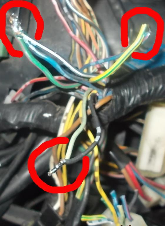

VerntureVet Posted September 17, 2015 #1 Posted September 17, 2015 (edited) The title says (RSU) that was a typo I should have put (RLU) Other posts covered this but a picture says 1000 words. To bypass the RLU on the my 1988 Venture Royale I unplugged the wires and soldered them together as shown in the picture. This will give you a functioning low/high beam and will also push power to the High Beam indicator when you have High beams on. The extra wire left on the plug would goto the Headlight Out indicator on the dash and is no longer needed. As the best indicator of a burn out headlight it lack of illumination on the road. Tie Together the Green/White + Blue/Black + Blue/White Tie Together Yellow/Green + Blue/Red Tie Together Black + LightGreen This will allow the High Beam light to work and let the light dimmer on the handle bar change from between Hi and Low Beam The Yellow wire if for the White Head Lamp Out Indicator and is no longer useful. Edited September 25, 2015 by VerntureVet
KIC Posted September 21, 2015 #2 Posted September 21, 2015 What is the purpose of the RSU and why by-pass it ?
Flyinfool Posted September 21, 2015 #3 Posted September 21, 2015 I think he meant RLU hence Reserve Lighting Unit. The purpose of the RLU is to monitor the headlight. If the low beam bulb is on and it burns out it will switch to the high beam, likewise if the high beam is on and it burns out it will switch to the low beam. This is so that when you are cruising down the highway at 70 at night and THE headlight burns out, the world does not go direct to black. The RLU also turns on the white headlight indicator on the dash to make sure you know that it has activated. The reason that you have to bypass it is that it uses amp draw to determine if the headlight burned out, if you install modern lighting that uses less power, the RLU can decide that it is a burned out bulb and switch to the other beam, but then tat will also be lower power so it will switch to the other beam. You will end up switching back and forth very fast and can damage your new modern light. The RLU is completely separate from the jumping of the dash display, that is a separate and redundant method for the bike to tell you that your headlight is out. The lack of illumination on the road method does not always work during the day.
VerntureVet Posted September 21, 2015 Author #4 Posted September 21, 2015 FlyinFool Nailed it. I installed an aftermarket LED headlight and the RLU had a fit so it had to find a home in my miss. parts box. On a side note I was getting a non stop CMU warning for the Headlight and the brake light when it was working. After bypassing the RLU I had almost 2 amps less draw on the battery. Changing to LED head light gave me almost another 3 amps less draw. changing the marker/turn lights to LEDs dropped it by 3-4 more + almost 1.5 amps when blinker or tail brake light was on but cause a rapid blink so installed load resistors to slow it down and lost some of the gain. This will work until I solder up a low power solid state blinker relay replacement. As it sits with the MOD about I have dropped idle battery draw by 8-11 amps. I am also working on replacing my dash lights with LEDs by using $1 cigarette lighter usb adapter and LED and a 1/4 watt resistor.

stanG Posted September 22, 2015 #7 Posted September 22, 2015 The picture is great... but you can't really tell exactly what the color codes are. Can you post the list?
VerntureVet Posted September 22, 2015 Author #8 Posted September 22, 2015 @stanG Flyingfool used off the shelf 194 LED replacement bulbs Most auto parts stores have them ranging from $2-$9, big department stores like k-mart or wal-mart also have them. Its the easiest way to replace them and Flyingfool said the stock dimmer still works. try Super Bright LEDS they have lots of other colors the stores may note have. Myself I built a driver unit out of a few cheap cigarette lighter usb chargers from the $1 store, a project box, some LEDs from DigiKey, and some 100ohm resistors. The only advantage I guess my setup has is the I am able to control how many amps the bulbs draw as a total package, I got to puick colors I wanted like red, blue, white, purple, yellow, and green, and with a future addition of a cheap PLC I can program the strings. I have all the dash lights, Running lights, Tail/brake Light, turn signals, and over 50 accent lights all over the engine and bike. All costed me under $30 and a few days wiring. I have a test button on the box that lights up all the lights. with all over them on the total draw is only 2.4 amps and I can light up the engine, wheels, fenders, and road in any color I want.

stanG Posted September 24, 2015 #16 Posted September 24, 2015 Not to rain on your parade of discussion of LED dash lights and such but I was referring to the photo of the wires soldered together from the reserve lighting unit. The color codes of the wires. As for replacing all incandescent bulbs with LED... been there, done that. ALL the bulbs on my bike are LED.
VerntureVet Posted September 25, 2015 Author #17 Posted September 25, 2015 @stanG I updated the OP to include wire colors sorry I missed that in my LED rant. Tie Together the Green/White + Blue/Black + Blue/White Tie Together Yellow/Green + Blue/Red Tie Together Black + LightGreen This will allow the High Beam light to work and let the light dimmer on the handle bar change from between Hi and Low Beam The Yellow wire if for the White Head Lamp Out Indicator and is no longer useful.
Flyinfool Posted September 25, 2015 #18 Posted September 25, 2015 @stanG I updated the OP to include wire colors sorry I missed that in my LED rant. Tie Together the Green/White + Blue/Black + Blue/White Tie Together Yellow/Green + Blue/Red Tie Together Black + LightGreen This will allow the High Beam light to work and let the light dimmer on the handle bar change from between Hi and Low Beam The Yellow wire is for the White Head Lamp Out Indicator and is no longer useful. The yellow wire for the Headlight indicator on the dash can also be reappropriated to use as an indicator for any other electrical stuff on the bike. I have my headlight setup an a switch so that it does not turn off and on when I hit the starter. Saves wear and tear on the headlights starter circuit, I have a HID headlight. I put a bright red LED behind the white headlight lens wired so that it is on if the headlight is off, in the daytime I was occasionally forgetting to turn on the headlight after starting.
