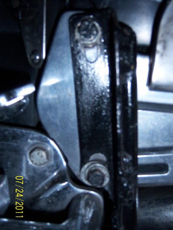

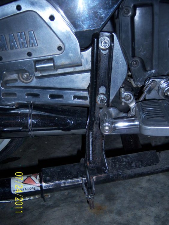

Arielrider Posted July 23, 2016 #31 Posted July 23, 2016 I HAD TROUBLE WITH MY VOYAGER TRIKE KIT AND HAD TO HAVE IT ADJUSTED SEVERAL DIFFERENT TIMES. I FINALLY MADE A PIECE FOR EITHER SIDE THAT BOLTS TO THE SIDE OF THE BIKE AND TO THE FRAME OF THE KIT. THIS TOOK CARE OF MY PROBLEMS AND IT RIDES LIKE A TRIKE WITH A STRAIGHT AXLE NOW. THERE'S NOT MUCH LEAN IN CURVES, AND IT'S A GOOD BALANCED RIDE . I WILL BE GLAD TO YOU PICTURES IF YOU GIVE ME YOUR EMAIL ADDRESS. Would you pop the pics off to me also? My kit is quite temperamental too..would like to view what you did// Thanks, George
Arielrider Posted July 23, 2016 #33 Posted July 23, 2016 Thanks, pics look good. George. I HAD TROUBLE WITH MY VOYAGER TRIKE KIT AND HAD TO HAVE IT ADJUSTED SEVERAL DIFFERENT TIMES. I FINALLY MADE A PIECE FOR EITHER SIDE THAT BOLTS TO THE SIDE OF THE BIKE AND TO THE FRAME OF THE KIT. THIS TOOK CARE OF MY PROBLEMS AND IT RIDES LIKE A TRIKE WITH A STRAIGHT AXLE NOW. THERE'S NOT MUCH LEAN IN CURVES, AND IT'S A GOOD BALANCED RIDE . I WILL BE GLAD TO SEND YOU PICTURES IF YOU GIVE ME YOUR EMAIL ADDRESS.
Condor Posted July 23, 2016 #34 Posted July 23, 2016 Interesting pics. I'm wondering if you could have put more preload on and accomplished the same thing???

Condor Posted September 22, 2019 #41 Posted September 22, 2019 For you riders that are requesting pics if you scroll up to the start of this thread they are already posted.....
