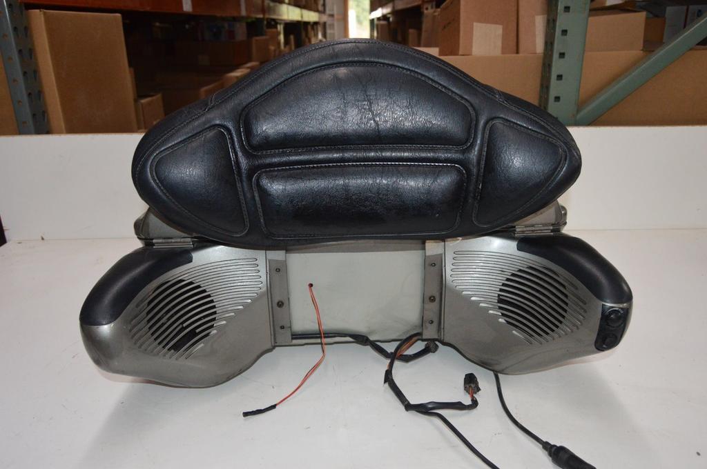

Marine speakers just don't sound that good. I have an 86 I cut out the so I could add 5.25 speakers. I was using a Jensen MS30 marine gauge stereo. It put out power about the same as a car head unit. It sounded ok even at highway speeds. I tried a couple of cheap amps and was disappointed. I just added a JVC xc2410 amp with a pair of 5.25 kickers and I am very happy with the quality and volume of the sound. I have always used car speakers as long as they didn't have a paper driver. You will need an amp to power 6x9s. If you are still concerned Hog tunes makes speakers for motorcycles that are water proof. I tried a pair of their 5.25 but liked the kicker sound better.

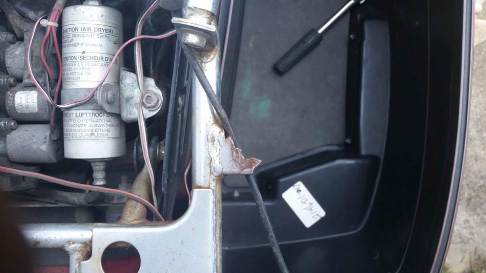

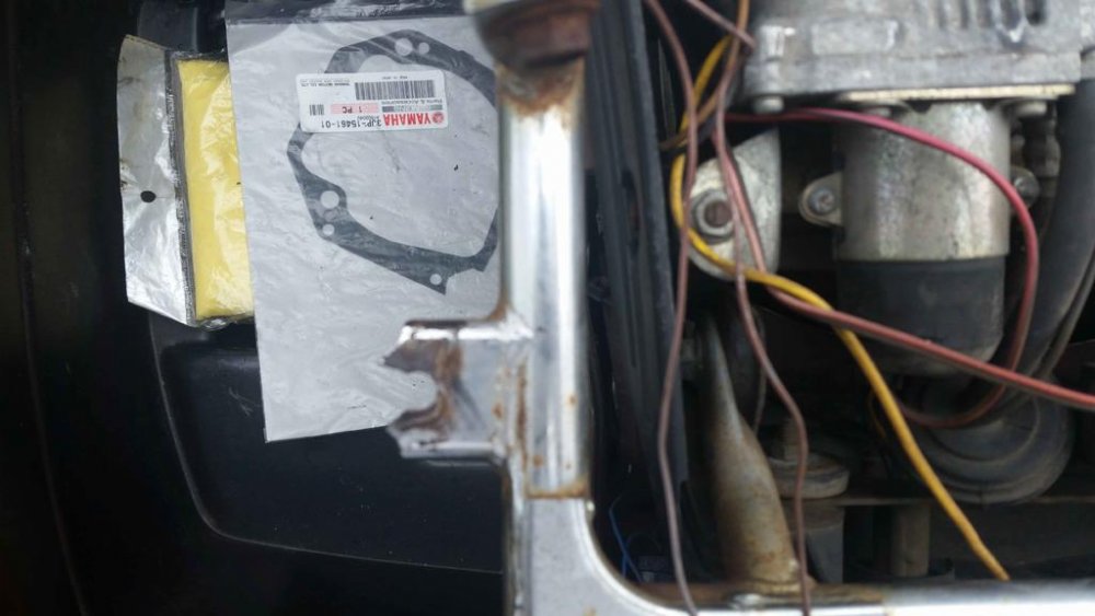

I saw 5 or 6 and all but one had a broken right tab. The one I bought looked good but when I got it the right tab was cracked. -
While dealing with a broken trunk mount http://www.venturerider.org/forum/showthread.php?123851-MKII-trunk-mount I came across another issue. A while back some one talked about the retainers that support the trunk when it's open not being even, of course mine were not. The right side had been bearing the load. This led to about a 3 inch crack right along the arm rest. To prevent any further stress on the trunk lid I just disconnected both sides and it rest on the seat when opened. I will not be using them anymore.

I found one on ebay that wasn't broken. I think I will have it beefed up at a machine shop. Thanks -
I was doing some other things on my 86 and noticed the trunk was loose and rocked back and forth a lot. Upon further inspection I found the 2 forward mounts broken. I removed the trunk and found the back of the trunk was cracked from completely across from the rear 2 mount points. I'm guessing the front issue led to the rear issue. Wife never mentioned it was loose. Check your bike it looks like one side had been repaired before.
