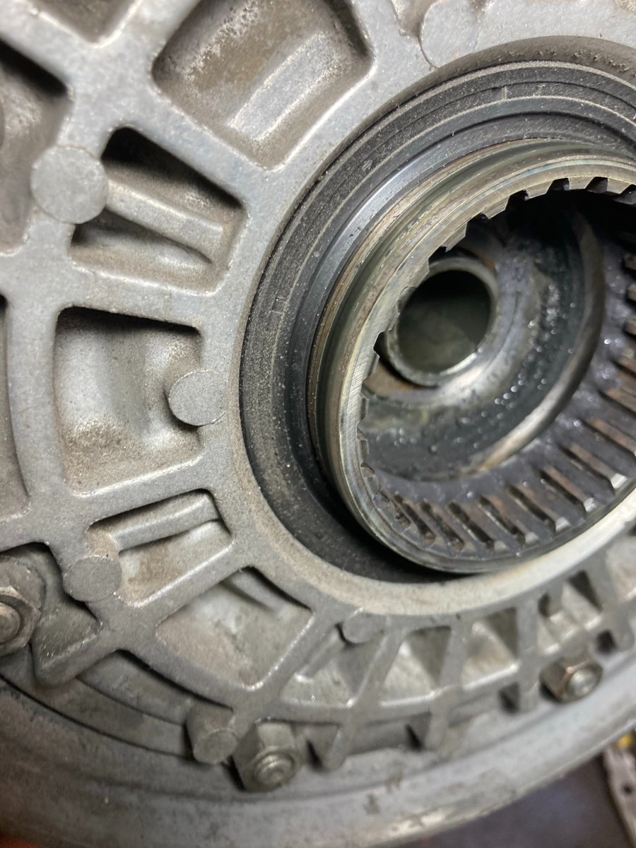

So here we are again. Glad to find the thread again. So last summer I had to replace my differential and maybe the drive side because again it looked worn. This thread documents my previous drive side replacement in 2018. I can say the Honda Molly paste or what ever it is technically called does not work. Maybe the poster was correct that this product is an assembly lube and not spline grease. It was recommended by my local shop owner whom I trust but clearly it is not cutting it (see photos). I am going to try the Sta-Lube product this time. It is very interesting to learn of the heat build up. I never gave that much thought but it looks to me like this grease is getting baked. So the conclusion is that some differentials run cooler than others and age or wear and tear might be the cause. This make sense since this problem did not present it self when the bike was much newer. So maybe I should look at rebuilding one of these differentials to remedy the heat build up problem. -

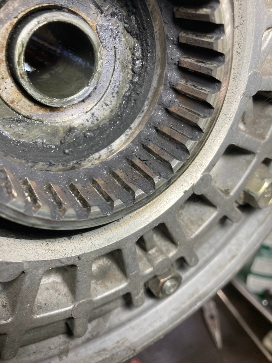

I love and hate this bike. I figured I do some winter maintenance since I had the bike up on the stand. Pulled the rear wheel to see how my molly paste was holding up on the differential and this is what I found. I don't think there was more than a few thousand miles on the grease since you can see from the tire with the screw in it (dam it) that I had it off recently to put the tire on. Middle of last summer I think I put the new differential on since the old one was toast. Greased it up with some of Honda's ridiculously expensive molly paste and this is what I get maybe 5 thousand mile later. Something causing more heat build up than it should or something. Both of these parts looked good when I put it back together. I have cleaned them up and they don't look bad enough to need replacing. Curious what others are finding. Could this grease be the problem. It was highly recommended. -

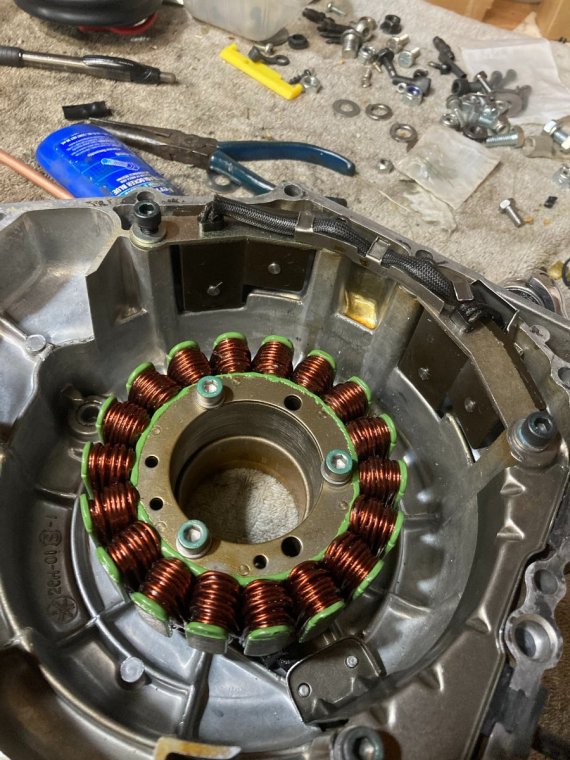

Making progress. I looked for a place for the new voltage regulate (Mosfet). Won't go where the old one was and really did not look like under trunk was great. I pulled both front fairing panels off (some plastic repairs were needed anyways) and I could not find any room there either. Did not like the nose cowling either so I went looking around believe I found a good place for it. I also am curious what the two holes with rubber plugs in them are for on the inside rear fender. It worked out perfectly for the plate that came with the Mosfet and from what I can tell the whole thing will close back up with out any problems. Not a great deal of air flow back there but neither would there have been inside the fairing. We will have to see. I also posted some photos of the refinishing of the passenger floor boards. They had looked bad like the engine covers for years with the clear coat making impossible to refinish. I got the paint remover out and cleaned them off and started sanding with the 220 girt. What a pain. Went to Harbor Freight and finally purchased a sand blasting box. In 5 min I had the one cleaned up and took it to the buffer. The other I had sanded with the 220 for maybe an hour or it seemed that way and it did not look great. Polished both on the monster buffing arbor they both came out looking way better. I am working on the plates. I am going to try sand blasting followed by sand paper down to 600 grit. I think it will be easier after sand blasting and they should shine up nicely. I don't plan on taking this bike apart every winter to clean it up but minor or major repairs seem to be making this an annual job. By the way. I have been waiting a long time for a gasket and wonder if there is not a better source. I gave up on waiting for the middle gear cover gasket and used the one I made. It was not pretty but I think it will work. Don't let anyone tell you it is easy to make your own gaskets. If you have to it can be done but I am going to order a clutch cover gasket and water pump gasket now. Those covers are coming off sometime in the future when I get around to shining up that side. You don't see much this motor but those are the parts that you do see. I think cleaning them up will make a big ascetic impact. -

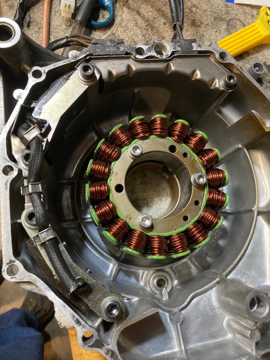

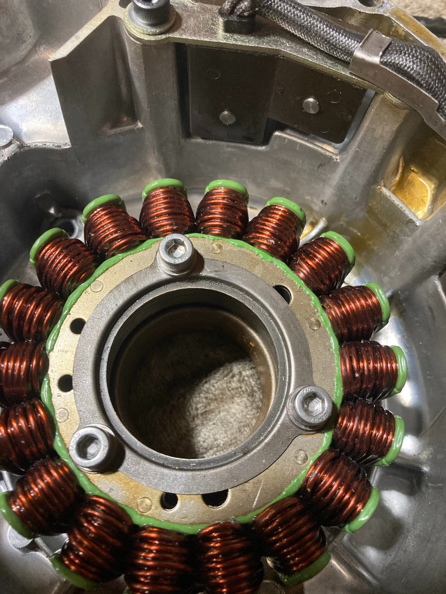

I decided tonight was the time to get some parts back on. I tried to seat the stater and cover but it rocked back and forth. I looked closely at the new socket head bolts I used to replace the screws and decided to take them out one at a time. First thing I noticed was the blue locktight did virtually nothing. The bolts turned right out. I also decided that the cover was not seating because the rubber grommet holding the pick up wires was a little higher than the cover. I took all the allen head bolts out and cleaned out the holes again with break cleaner, dried them out and put red lock tight on them. Put the cover back on and then found the ring on the work bench. I doubt it was really needed but yes I took it all apart again because I thought that red lock tight might work and make it difficult to remover the bolts later. I also could not remember if the shift shaft went up or down. I looked through the shop manual and eventually found a diagram showing it up. We will see how this works.
I like this idea. I determined that Earl was correct and while you can get the bolts to line up, the Mosfet will not fit where the stock one was located. I almost pulled the truck off today but since the lower cowling is off maybe that is the place for it. I guess you had to drill a couple of holes in the cowling to get it attached?
I like the idea of mounting it under the trunk. I will have to look and see what kind of room there is under there. My mosfet came with the mounting bracket that looks like it might mount to the two holes the stock regulator was mounted to. Then you mount the the mosfet to the plate. I suppose the stock location is fine but it is tight and does get some road dirt. It also looks like pulling the muffler off would be necessary to really get in there. We will see. I would say the underside of the trunk is not some place I want to drill holes but if I remember I had to make a significant fiberglass repair in there a few years back when the bottom came apart. So many repairs over so many years. How can I ever part with this bike. We have been through a lot of life together. I really feel for guys that are selling their's because they are finally having to give up riding. I suspect I will be there someday. Maybe I can just ask to be buried with it.
I looked at installing the new Mosfet R/R last night and even using the universal mounting plate provided I have my doubts about it mounting in the original location. Anyone have a photo of where they relocated theirs. The photo is the new stater installed and ready to get mounted.
I got this far with the project. new stater installed and bolted down with new hex head bolts and blue locktight. Looked at the new voltage regulator rectifier (mosfit) and universal mounting plate and don't think it is going to be all that easy to get it installed where the old one sat. Love to see where others have relocated theirs.

I have been cleaning up surfaces which was no easy task. I suspect that a little remnant material on either surface is not going to result in a leak but I scraped and scrubbed down to as smooth and clean as I can get. So the question is do I really need any gasket sealer on these to covers. I put the primary cover back on my Vision without gasket sealer and it seem fine. Anyone have experience with this that can chime in. I am close to re-assembly. I also pulled the two retaining screws and the voltage regulator/rectifier dropped right out, sort of. Not sure if the new Mosfet will slide up in there without pulling the muffler. I ordered a kit of electrical connectors off Ebay (https://www.amazon.com/gp/product/B08CDNTSLF/ref=ppx_yo_dt_b_asin_title_o02_s00?ie=UTF8&psc=1) if anyone is interested. I also picked up a criping tool and removal tool. Pulled the kickstand switch while I was in there today and cleaned it up. I cannot see anything wrong with it and have no idea why it stopped working. I think I will put a connector on the wires and plug it back it. Right now they are cut and twisted together. And yes I have ridden away from a stop several times with the kickstand down. Not fun.
