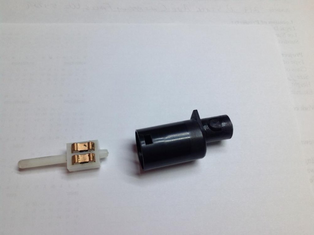

Just got back from a "spur of the moment" 145 mile run. I can honestly say I don't miss the clutch switch! -

I'm still in need of a clutch switch for my '89. In the meantime, I decided to bypass it and now I have my cruise back!!! In my opinion the clutch switch isn't as important as the brake switch when it comes to shutting down ur cruise. How many times have I shifted with the cruise on in the 20+ years I've owned it? - Zero times So until I find someone willing to part with one I'll live without it. Yamagrl found some on Ebay but they were for '83 & '84's and I'm not sure they are compatible with my '89 setup.

Well it's not ABS plastic so I'll try some plastic weld on it tonight. -

Hoping my ABS glue job holds. The small cylindrical part fits inside the clutch lever bracket. It broke where the larger cylindrical portion meets the smaller part. Am I missing a spring? The parts in the pic are all I had in my parts bag. I don't see how this is going to move when I engage the clutch lever so it disengages the cruise.
