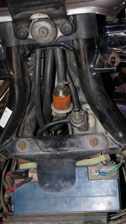

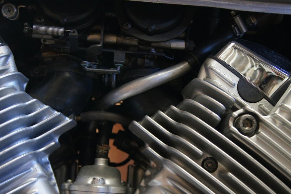

i modified mine about 3 months ago [sick of the oil in the air cleaner] i bent up some 3/8 aluminium tube from a car aircon system to a fuel filter them en extra 3" of rubber tube above the filter right up under the tank my plan was the oil could travel up till it reaches the filter [using it as a catch can] any fumes have to go through the fuel filter up through the extra rubber tube if any oil settles in the filter when the motor is off it will run back down the tube back into the motor i then filled with oil to the top of the sight glass i am happy to say i have clean air filter and no oil out the top of the fuel filter tube . -
