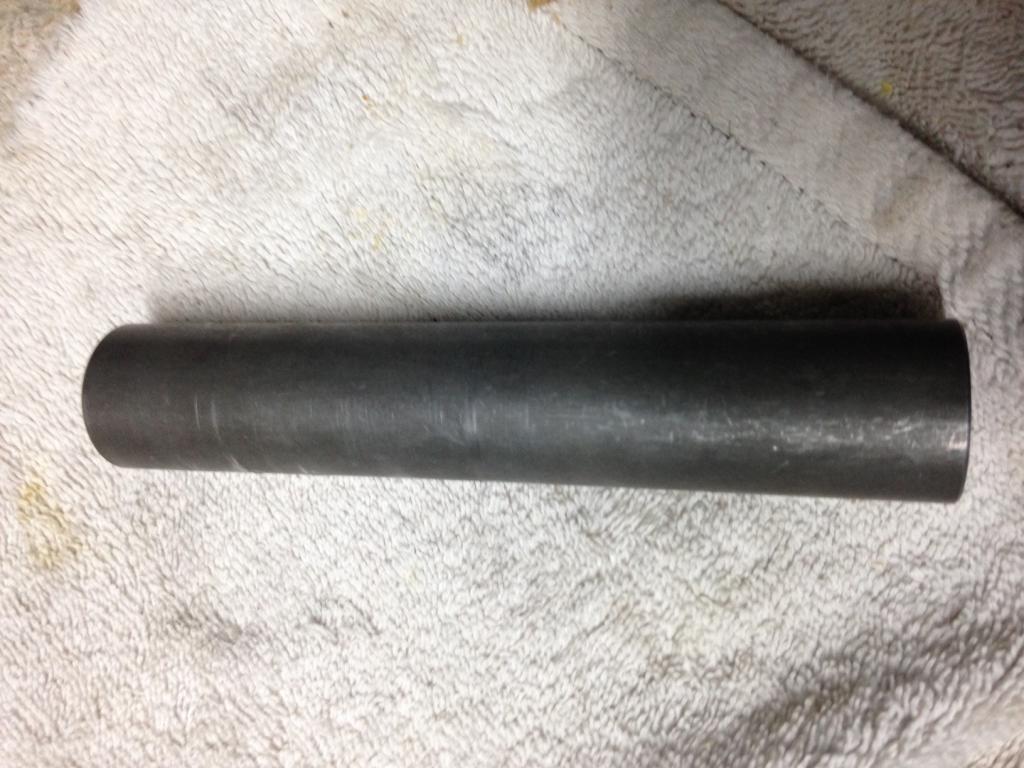

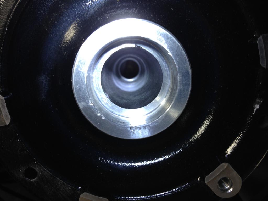

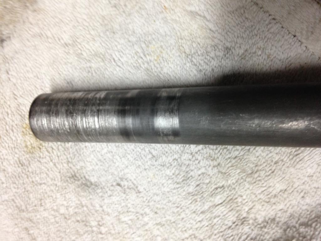

Thanks for ideas, So pretty much everything mentioned thus far I had also considered. Something is causing collar to rub against inside of hub. Everything seems straight as far as the naked eye, if either axle or collar was bent I would the think the axle would bind passing thru which it doesn't. Roll test the axle seems perfect. If i have to at some point I can take axle & collar to brothers house about an 1 1/2 hour away and put on his lathe. I had taken out one bearing thinking they were bad, that's when I discovered collar had been rubbing, on the side I took out there appears to be an 1/8 inch or space between collar and hub, would think the other side of hub the same however I didn't pull out bearing, partly due to brake disk mount screws almost impossible to get out due to locktite and torqued in and the fact that now the bearings seemed fine so no reason to pull out bearing, I wanted to leave it as much as possible as dealer had left it. I guess its possible collar was enough out of round on one end to now hit the new hub, don't see how collar would ever be damaged due to being inside hub unless being way over torqued to the point of causing collar to bulge out enough now rub inside of hub. Not sure you could over torque that much by hand. Now it wouldn't surprise me that the shop would over torque it as poor as the other work was that they did. Rolling collar on a flat surface it appears to be perfectly round and straight but now scrapped as seen in photos. Took the wheel, spacers, axle to different dealer (but now part of same chain, used to be independent). Older tech couldn't tell what was going on without pulling bearings and taking measurements which they agreed to do at no cost to me. So will see what they say. I'll post back results for future references. -
So while troubleshooting noise in drive train I discovered a noise in front wheel, after pulling front wheel I discovered what I thought was a bad wheel bearing making noise each time wheel rotated. Turning bearing with finger could feel what felt like rolling over gravel, went ahead and ordered new seals and bearings, they came today, was in the process of removing bearings, removed left bearing and nothing wrong with it, pulled out collar and low and behold that's what is rubbing. See photos below. Axle and collar both seem perfectly straight, both bearings seem fine. Now mind you this is a new wheel & bearings installed by dealer about 4K mi ago after an accident. Its probably been rubbing ever since work was done, just been getting worse. In the pic you can see on the bad side of the collar where it is rubbing, and looking inside hub can see shinny area, notice collar only rubbing on one side. Only way to get collar out is to remove bearing. Any Ideas what the problem is, wheel hub defect?. The dealer didn't charge me for a new collar or axle so I'm assuming used old one. Did charge me (or rather my insurance) $700 for new wheel, bearings, and seals. Prob. going to take wheel by dealer that did work and see what they say. They did some other work replacing a few parts, I ended up having to go back and fix all their sloppy work, they even left some electronics under fairing disconnected. I wrote a nasty email to general manager of this local chain of MC dealers (Mountain Motorsports) here in Atlanta area. Local service manage offered to have another tech go over all the work they had done but I took a pass, had already fixed all their mistakes and didn't want them touching it again .
