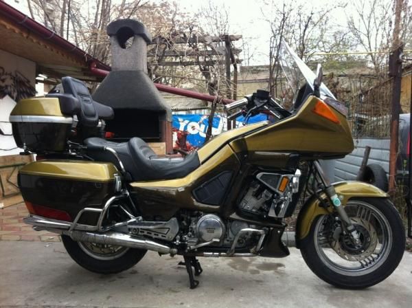

  4. quant55
    IMG 0204
    From the album: VR90 after rebuid
  5. quant55
    IMG 0200
  6. quant55
    IMG 0199
  7. quant55
    VR90 after rebuid
