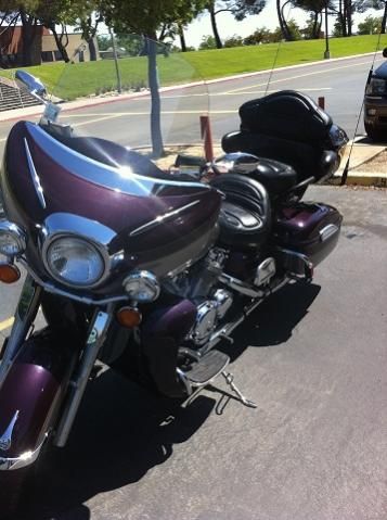

  10. As promised, here are some pictures of the baby...
