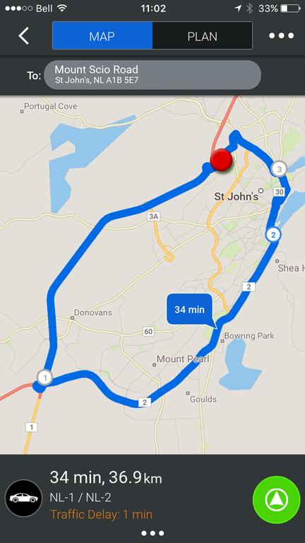

The 'Lunchtime Loop" Once around the perimeter of the city. Got the 'office fog' out of my head, and the riding smile back on. Had a nice 30 minute visit with my 2-wheeled therapist.
