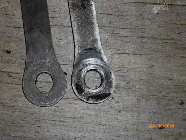

Jeff, I didn't notice the problem until I had it all apart. Therefore, no idea on the orientation. It is entirely possible this was caused by bottoming out. When my shock was bad, I believe I was heading back from Texas. Bottomed out hard enough for the rear brake caliper to put a small dent in the edge of the rear fender. New dogbones from DiamondR showed up today (included the bolts but I am ordering new ones from Yamaha anyway as I'm not sure of the hardness of the DiamondR bolts). Allen from DiamondR put a note in the box to pass along the word that they only have a few sets of leveling link dogbones left. Due to slow sales of this item lately, they likely won't remake any more. Will start a separate thread about this to let everybody know. RR

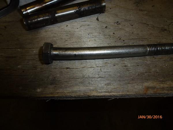

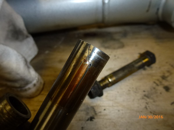

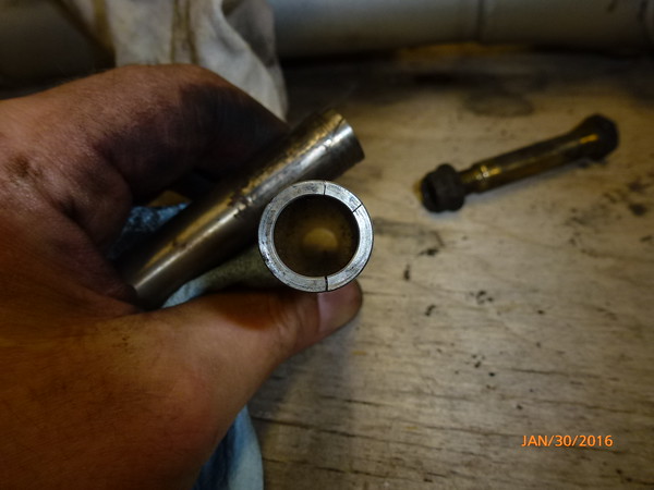

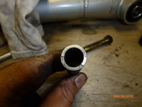

Am doing my first service on the swing arms bearings. There are only 140,000 miles on them (and they have never been looked at - whoops). One of the bearings was rough, so I replaced them both along with the seals. Easy peasy. However, while cleaning and lubing the shock/support pivots, I noticed something troubling. The leveling links / dog bones holes have been pounded oblong. One of the links was also slightly bent. This isn't good. I pounded the link back flat and went to reinstall. It turns out the bolt is bent. Pounded it back straight also. OK, this is odd. Went to clean up and regrease the collar/bearings where the shock linkage attaches to the swing arm and found ---- That bolt is bent also. Took the collar (inner race sleeve) out of the swingarm and it was cracked. It appears the needle bearings are still in good shape. Not sure what caused all this damage, but I am guessing the leveling links were not of sufficient hardness and they were pounded out of round. Things went south from there. The OEM shock went out at about 110,000 miles and I have been running a Baron replacement. Didn't notice the problems when I changed the shock out, but I didn't really look closely. Am purchasing new bolts and collars along with new leveling links. Guess it will be next weekend before I can button up winter maintenance on the Venture. RR P.S. Looks like some of the bearings need replaced also.
