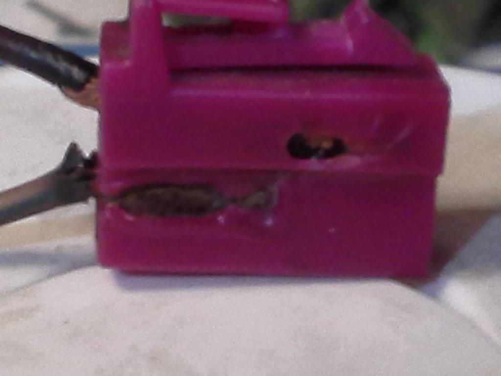

http://www.venturerider.org/forum/attachment.php?attachmentid=113079&d=1529205140&thumb=1&stc=1This is what i found before mine stopped running, this is a connection from my 99 IGN. switch. i installed a relay kit before it die on the side of the road, also in the manual section 8 page 8, there is trouble shooting steps for the ignition system. -

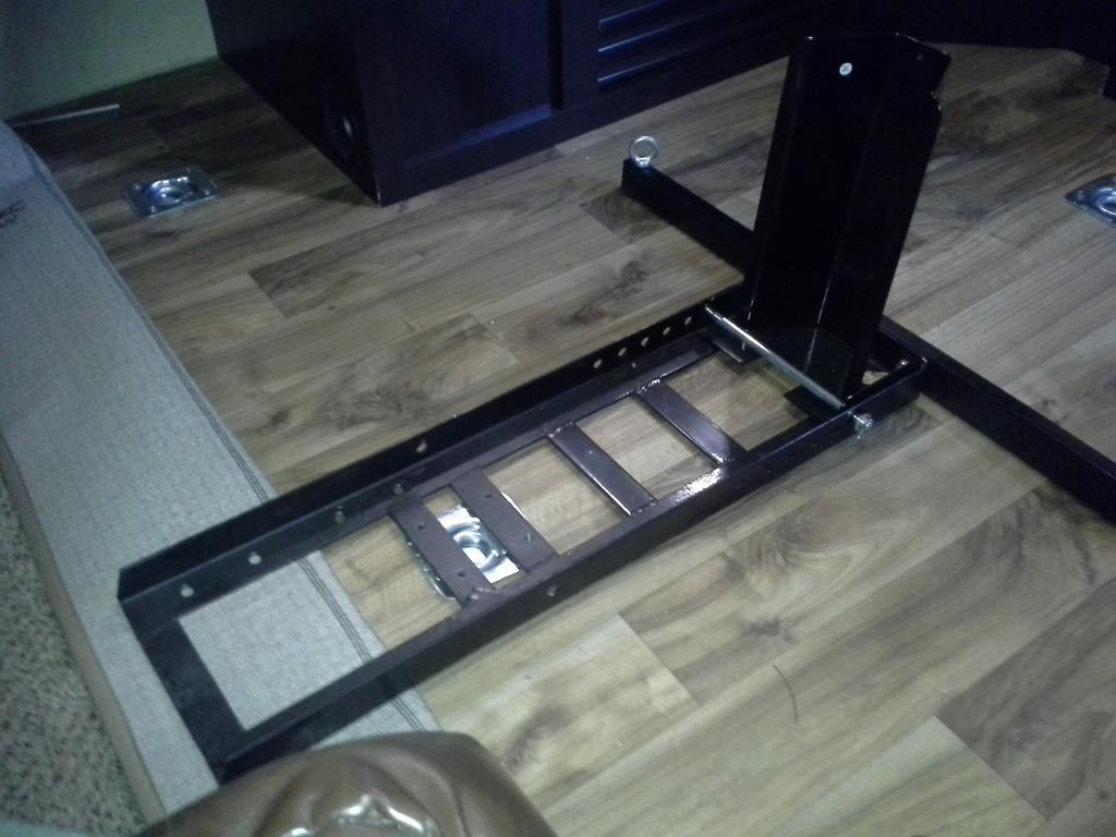

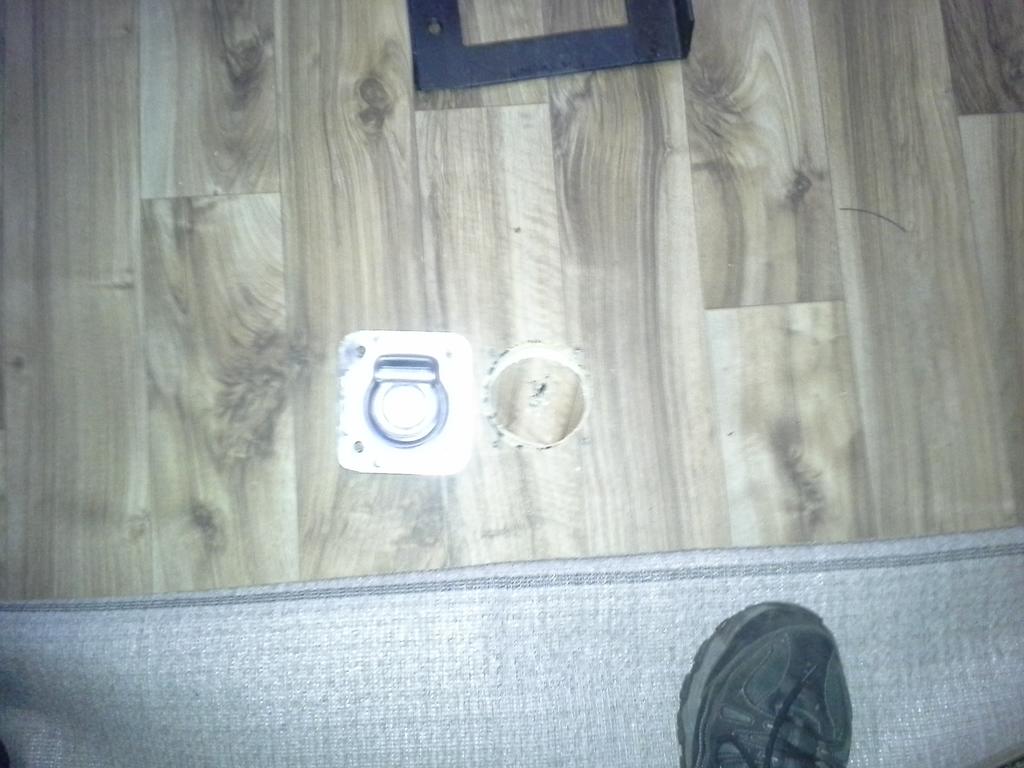

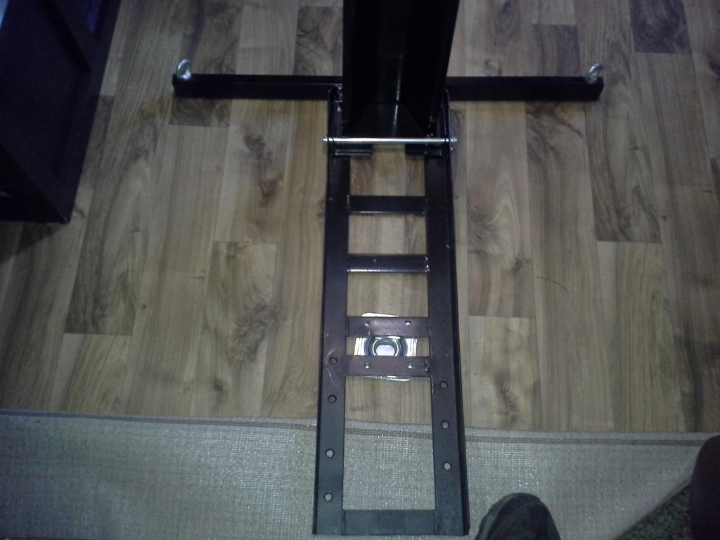

this is how i attach mine to the floor, even if you cant do it this way, it still has to be mounted to the floor, just get a throw rug to cover up the holes.
