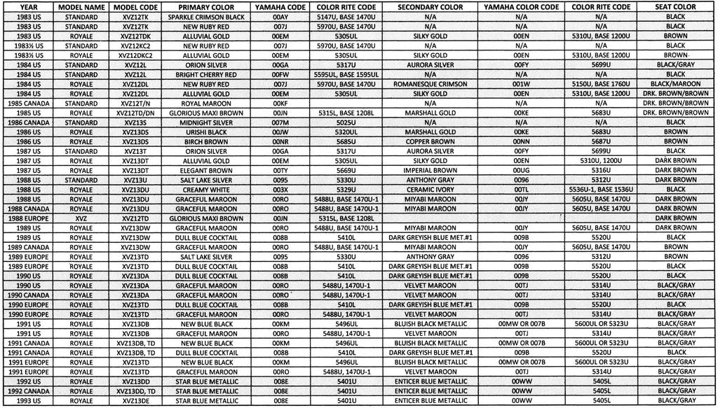

Thanks Prairiehammer Here is the correct colors (with both Yamaha codes and Colorite codes), but as has been said, computer color matching is the only way to get an accurate match of the aged and probably faded paint. [ATTACH=CONFIG]117083[/ATTACH] Venture Paint and Seat Colors.xlsx

That chart on the Venturers site is not entirely accurate or complete. Here is the correct colors (with both Yamaha codes and Colorite codes), but as has been said, computer color matching is the only way to get an accurate match of the aged and probably faded paint. Venture Paint and Seat Colors.xlsx -

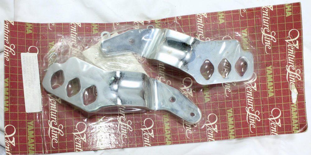

You are correct about the backrest as not FACTORY original equipment, because there was no FACTORY rider's backrest, ever on any Venture. But you are incorrect about the brackets, they did NOT come in a "factory package". Your backrest is a Yamaha VentureLine backrest accessory offered by Yamaha dealers. It was available in brown (Yamaha called it "Burgundy") or black (to match the particular Venture seat color.) Retail price in 2001 was $240! BTW: your offer of this backrest for free on the "Paying it Forward" section is very generous. The VentureLine backrest has been sold on eBay for as much as $190! The brackets alone have sold for $50. I have one for sale (in black), too. I am asking $120 + actual shipping costs. You will certainly move yours much quicker!

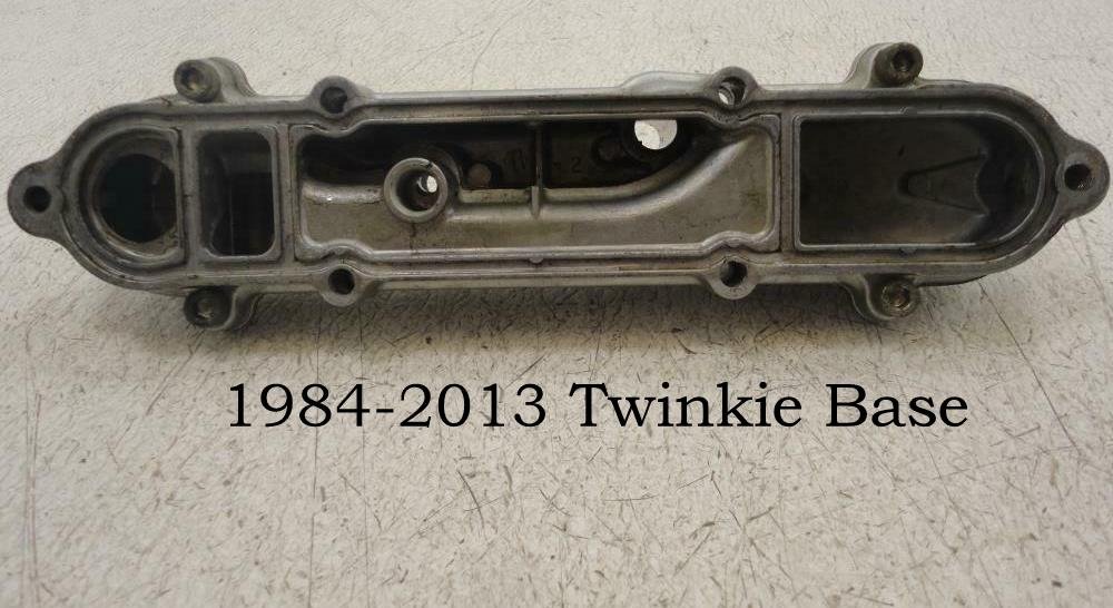

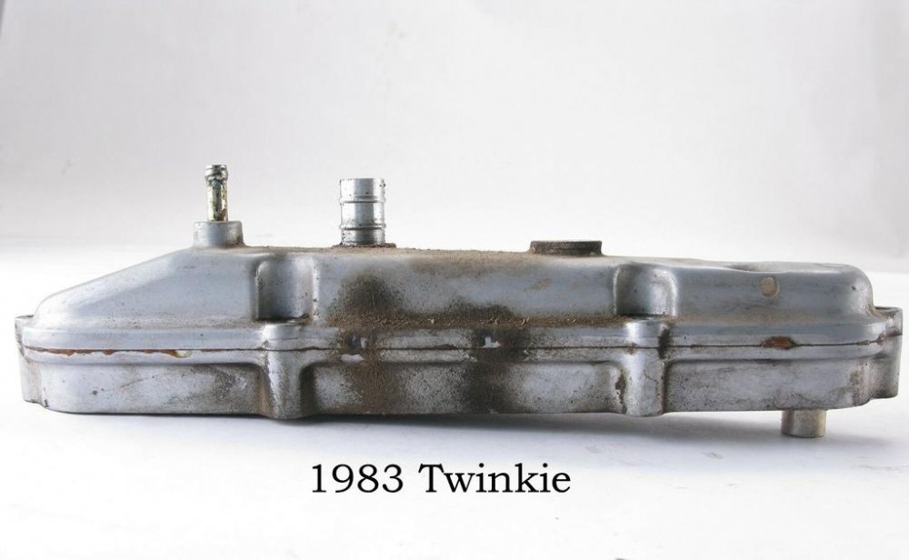

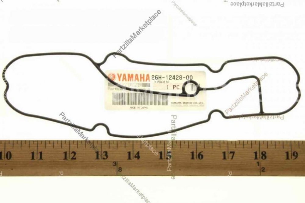

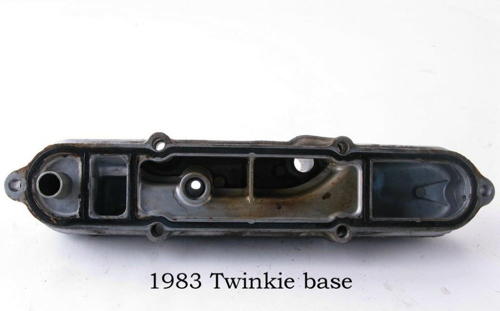

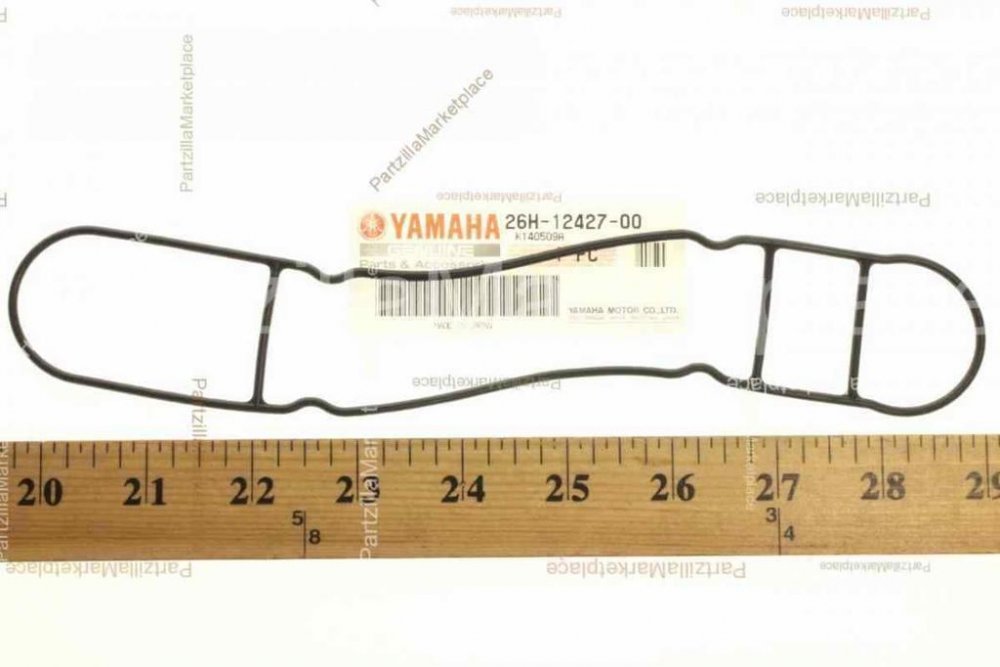

The "Twinkie" (that's the breather/oil distribution junction/coolant cover) contains two gaskets; one between the two sections of the Twinkie and one at the base where it mates with the crankcase. The Twinkie contains pressurized oil feeding the heads (the chrome lines with banjo unions), coolant and a crankcase breather passage. The gaskets are more akin to O-rings in composition and cross-section. The O-ring style gaskets become flattened and hardened (less resilient) with time and heat. Tightening the six mounting cap screws does not usually result in reducing the leak, because the housing bottoms out on the crankcase before the shrunken gasket is compressed. Because of the construction and purpose of the Twinkie, it is not uncommon for coolant to enter the engine oil or engine oil to mix with coolant when the gaskets fail. Check your coolant reservoir for milky tan oil scum and your engine oil level (may rise). It is doubtful that the gaskets can be replaced with the carbs in place (replace BOTH gaskets while the Twinkie is out). It would also be easier to access the Twinkie for removal if the intake boots are removed from the heads, but that may require replacement of the intake boot gaskets (also O-ring style gaskets).
