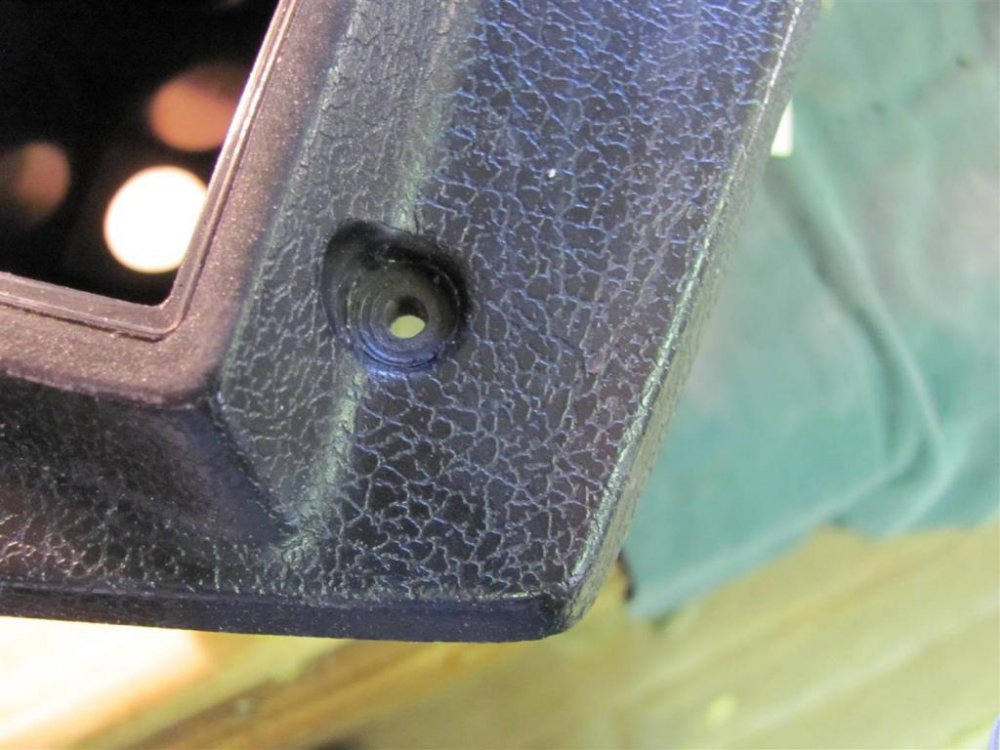

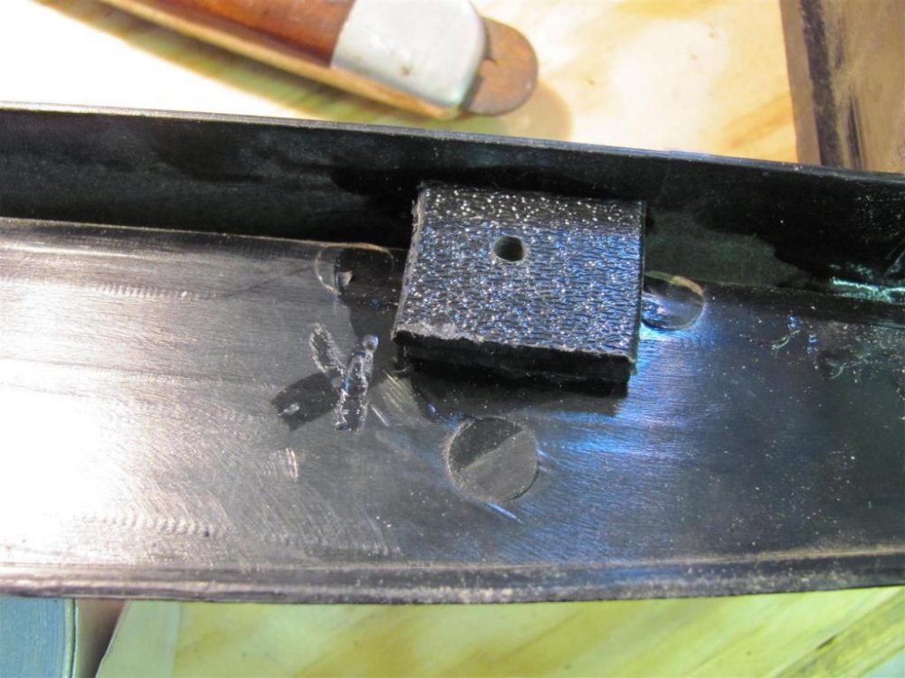

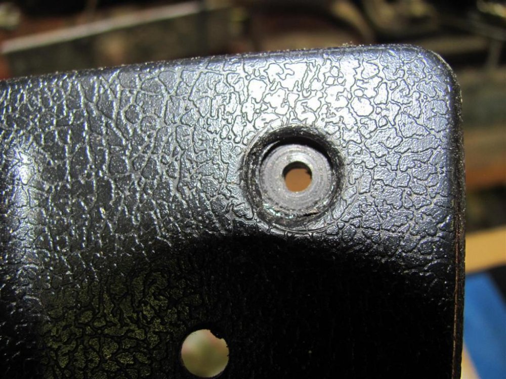

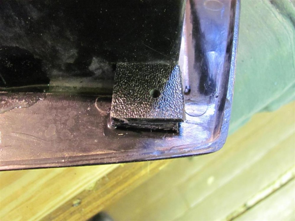

I also repaired the blown out bosses on the "Terminal Panel". All of mine on the '91 were "bottomless". My method of repair is different from the OP, but it has been an effective repair. First, I ground down the remains of the mounting bosses, so that the underside of the terminal panel was smooth. Then I glued two 1/8th inch thick squares of ABS to the underside of the panel, using ABS cement. I then used a Forstner bit, and bored from the top down into the glued ABS. I eye-balled the correct depth, leaving about an 1/8th inch under the Allen screw. More than was OEM. I also used MEK and ABS cement to repair cracks around the CLASS housing. -
