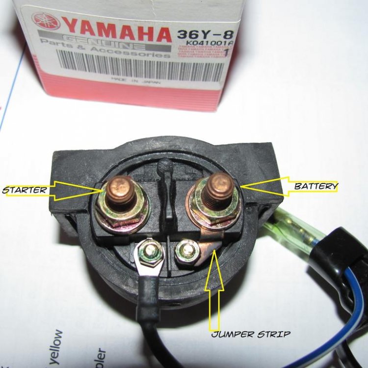

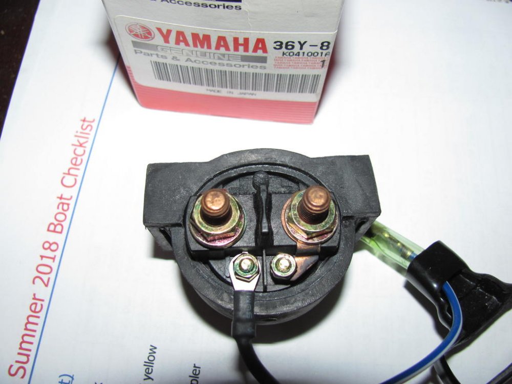

There is NO electrical connection internally from the blue/white wire to the either of the big posts. The blue/white wire simply completes the circuit for the internal solenoid coil. The blue/white is connected to ground when the start switch is depressed. Do not jumper anything to the small post that the blue/white wire is connected to. Again, lots of smoke if you do. With the positive battery cable hooked up to the "IN" side of the solenoid (as I explained above) and the starter cable hooked to the "OUT" side of the solenoid, simply grounding the blue/white wire should cause the starter to crank. -

NO! I hope you haven't hooked the "ground" cable to the solenoid yet! That would let a lot of smoke out! The positive cable from the battery goes on the big lug next to the small "unused" screw. The cable that goes to the starter goes on the other big lug. As I said earlier, the MKII solenoid with the single blue/white wire should already have the jumper incorporated from the big lug (battery side) to the small screw. -

The MKII starter relay (solenoid) has but one small wire, the blue/white. The second small screw is connected to the battery positive via a jumper strip built into the solenoid. Depending on the manufacturer of the solenoid, the jumper connecting the big post to the small connection may be internal or external (manifested by a visible conducting strip). -
