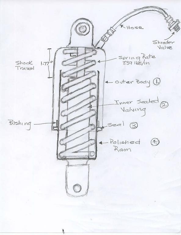

Anyone got a clue of how much oil is in a 1st Gen rear boinger?
Prairiehammer replied to cowpuc's topic in Watering Hole
Puc, the Second Gen rear shock IS substantially different from the First Gen shock. Here is a diagram of a Second Gen shock, courtesy of Rick Butler. Rick Butler Shock Diagram.PDF -
The air and oil are in two separate sealed chambers, isolated from each other. Releasing the air should not have released any oil. -
