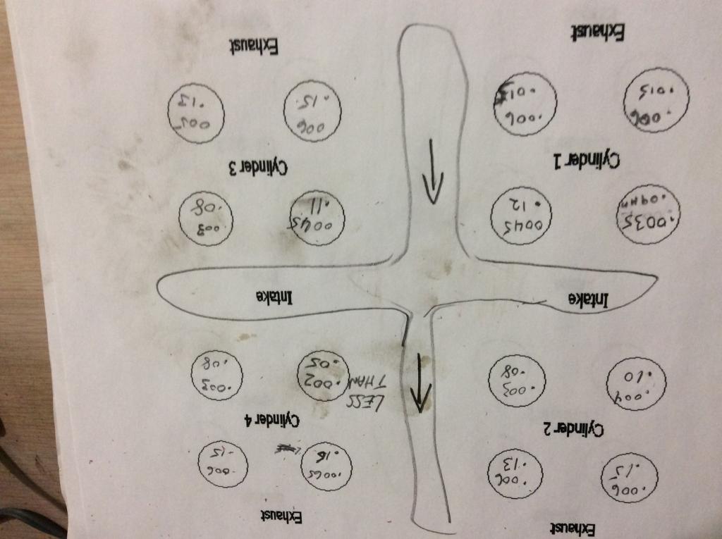

  23. OK...checked the valves... Heres my results the #4 inboard intake is scary tight! the measurements are inches above metric. the ones showing .xxx5 just mean it was a tight xxx
