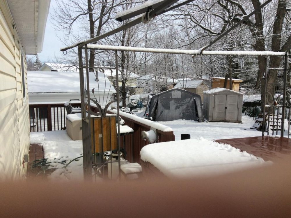

so what did I ever do to you? 2 days ago the only snow was a few piles that hadn't quite melted yet!!!!
