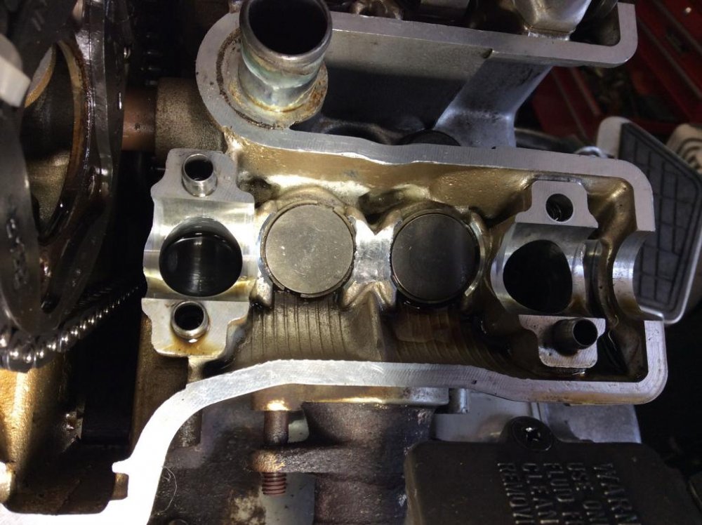

be REAL careful when you do the shims. If the tools slips or if you feel any resistance STOP!!!! I used a tool that had been broken and re-welded and I think it had bent so the opening was a bit wide and it didn't fit the cams properly. In my ignorance I used it any way and in so doing I mashed some of the aluminium between the lifters. I've tried grinding but several of the lifters are jammed. So now I had to pull the motor out of my parts bike and I'm going to use the heads off that. A LOT OF WORK!!!! Like I said...tread lightly. They say you learn from your mistakes and Hindsight is 20/20. I should be a genius by now an be able to see a pin head at 200 yards! -

No....looser but still not free. But now the motor is out it might be easier to grind. There was just no room at the front. I'm butchering the lifters in the process. so far I've been working on just the 2 cyl 3 exhaust lifters I'm going to pull the heads regardless. I'm thinking if I can push the valves up then it might be easier to remove the lifters....giving better access to grind the head as required. As it is now I can't get to all of it.
Replacement lifters are $40 each!! Head gasket about the same. looks like I'll be tearing into the parts bike for lifters anyway...might as well harvest shims too.

been grinding the head where it was mashed over the buckets. so far no success in releasing the valves and buckets. I can rotate the buckets by tapping them but they are by no means free....the buckets still won't return to normal height. I tried grabbing the shim bucket with a pair of needle nose but I can't get it out no how! I know they should because I tried one that was loose and it lifted out easily. I'm going to have to replace the shim buckets because there is no way to avoid grinding them at the same time. I zip tied the cam chain to the cam gears and removed the exhaust cam so I could work on the shim bucket area. in case I have to remove the heads.. I found the cam chain link but it looks as if both lobes are a grooved split rivet that spreads to hold. Do I just squeeze the split rivet together to remove or do I have to grind it off? I'm thinking probably not but I figured I'd ask to be sure......Are the heads and valves of a 1200 the same size as a 1300? I'm Thinking of my parts bike and just swapping heads

Just for curiosity I priced valve stem seals from the stealer. $16 and change EACH!!!! so that's not going to be done either. Not that I need it....thank goodness! I'm trying to get the valves loose without pulling the head. Just as well...they said the head gaskets are back ordered anyway
once again Jeff is right on! Instead of pulling the heads I just lifted the exhaust cams. This is what I found....
