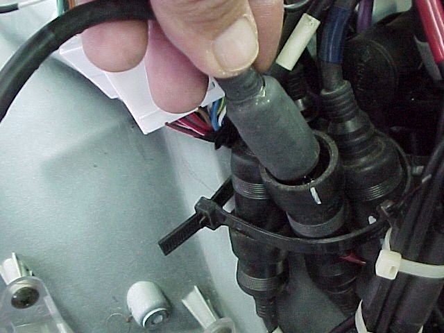

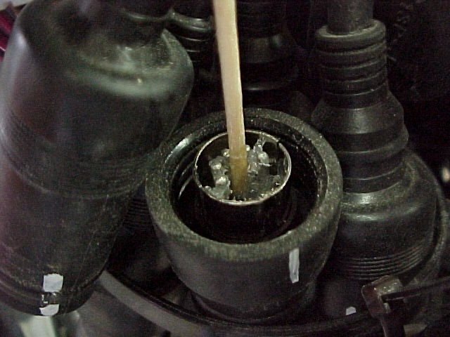

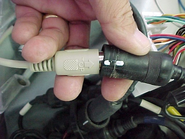

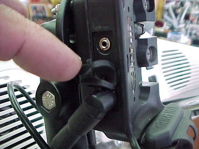

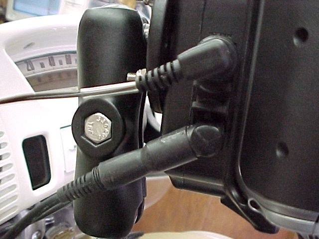

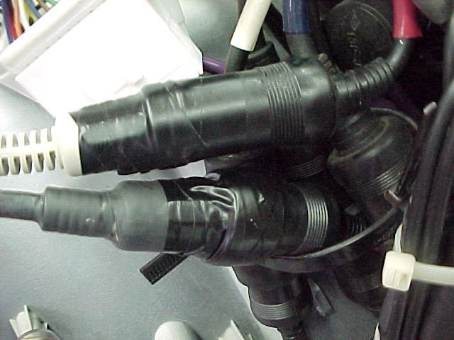

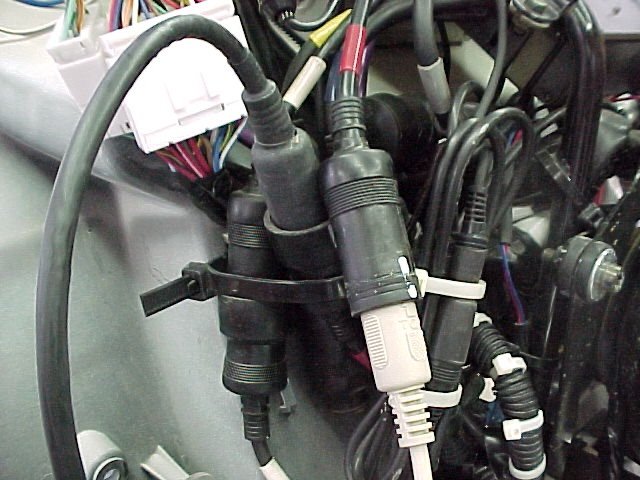

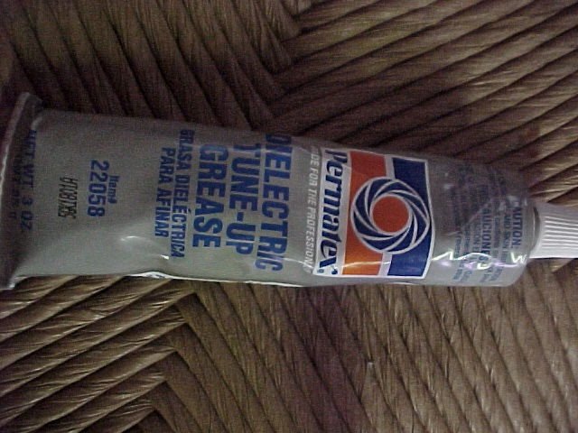

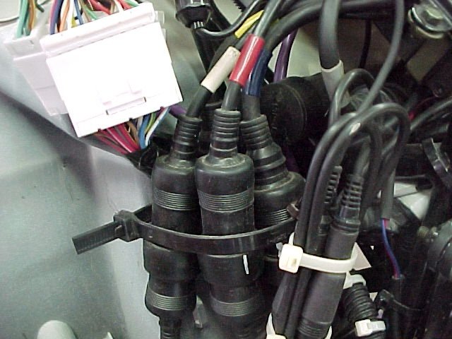

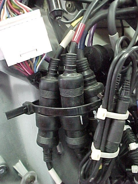

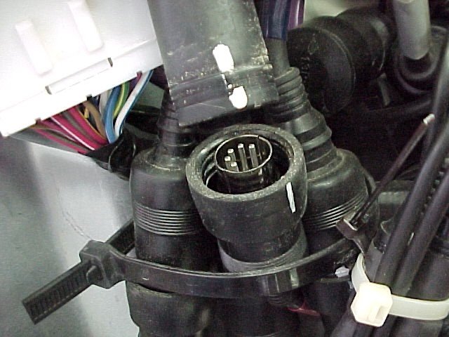

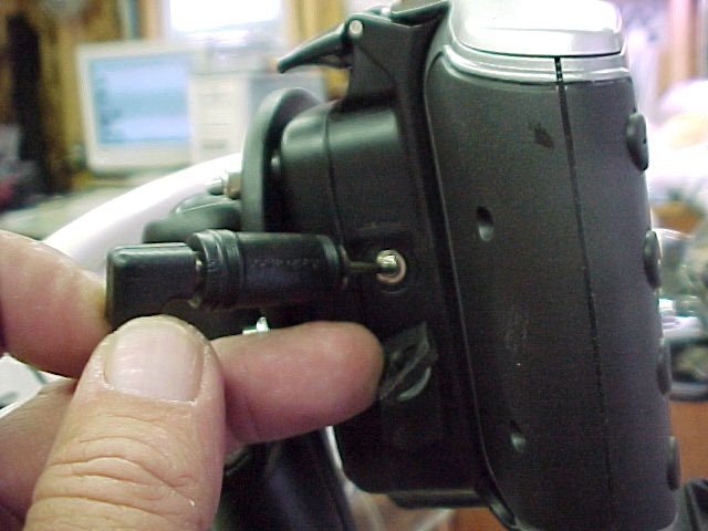

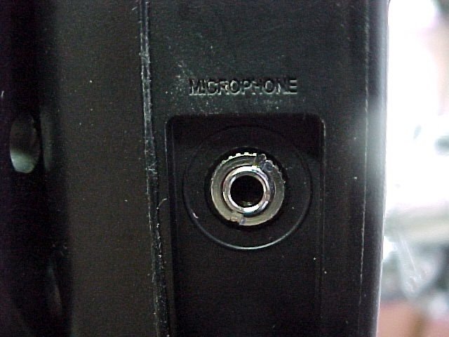

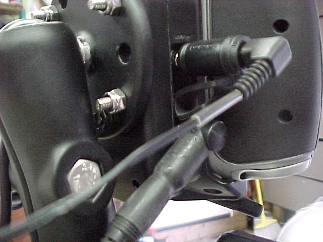

I Just received the Buddyrich cable last week and had some time today to install it. I like some of you need pictures and and maybe how too Instructions. # 1 Remove Fairing # 2 Looking from the front of the bike on the left you will see this cluster of color connectors (Lift the RED Connector up a bit and un-plug it. # 3 I put a little DIELECTRIC grease in the cables # 4 Now take the BuddyRich Cable and plug it into each of the bikes corresponding cables. # 5 This is what it looks like after the New Cable is plugged in. # 6 Take some Black Electrical Tape and wrap them up to help water proof them. # 7 Run the Small wire from the BuddyRich Cable through your fairing up the (MICROPHONE IN-PORT) on the Zumo Cradle # 8 Turn Zumo on and make it find your Cell Phone.. (TEST IT) Plug your helmet into your bike connector like always then have your Radio System on AUX switch to headset and make your call. I also Ran my Other 3.5 Connector in the AUX Port on the Zumo Cradle For my Loaded MP3 Music that I play from my Zumo. My Findings Were More then I Expected. The set-up worked perfect. I first called my Daughter from the bike with my helmet on from the garage. she could her me perfect and I could here her perfect as well. Then I Had my Wife come out and put her helmet on she could hear the call being made and My Daughter talking to me. My wife could not talk to our Daughter. But she could tell me what to say to her from helmet to helmet. Also , with the Zumo's MP3's Playing it will Mute it when the call is being made or coming in. I also was able to have the speakers on the bike on (not the H/S) and hear and talk to my Daughter. So for the price this set-up works PERFECT! Thanks Buddy for taking the time and making these cables for us. (Buddy make sure you add anything else I Forgot before Don puts this into the TECH Files.) I Hope this helps some of you folks. (not sure why these two photos are at the bottom of this page) Jeff
I Just received the Buddyrich cable last week and had some time today to install it. I like some of you need pictures and and maybe how too Instructions. # 1 Remove Fairing # 2 Looking from the front of the bike on the left you will see this cluster of color connectors (Lift the RED Connector up a bit and un-plug it. # 3 I put a little DIELECTRIC grease in the cables # 4 Now take the BuddyRich Cable and plug it into each of the bikes corresponding cables. # 5 This is what it looks like after the New Cable is plugged in. # 6 Take some Black Electrical Tape and wrap them up to help water proof them. # 7 Run the Small wire from the BuddyRich Cable through your fairing up the (MICROPHONE IN-PORT) on the Zumo Cradle # 8 Turn Zumo on and make it find your Cell Phone.. (TEST IT) Plug your helmet into your bike connector like always then have your Radio System on AUX switch to headset and make your call. I also Ran my Other 3.5 Connector in the AUX Port on the Zumo Cradle For my Loaded MP3 Music that I play from my Zumo. My Findings Were More then I Expected. The set-up worked perfect. I first called my Daughter from the bike with my helmet on from the garage. she could her me perfect and I could here her perfect as well. Then I Had my Wife come out and put her helmet on she could hear the call being made and My Daughter talking to me. My wife could not talk to our Daughter. But she could tell me what to say to her from helmet to helmet. Also , with the Zumo's MP3's Playing it will Mute it when the call is being made or coming in. I also was able to have the speakers on the bike on (not the H/S) and hear and talk to my Daughter. So for the price this set-up works PERFECT! Thanks Buddy for taking the time and making these cables for us. (Buddy make sure you add anything else I Forgot before Don puts this into the TECH Files.) I Hope this helps some of you folks. (not sure why these two photos are at the bottom of this page) --1/12/12 -- NOTE:: I have noticed that the 3.5 connector will fail after a year or so , so I have been going with the (GOLD PLATED ENDS) they seem to last longer from all the vibration going on. Jeff
