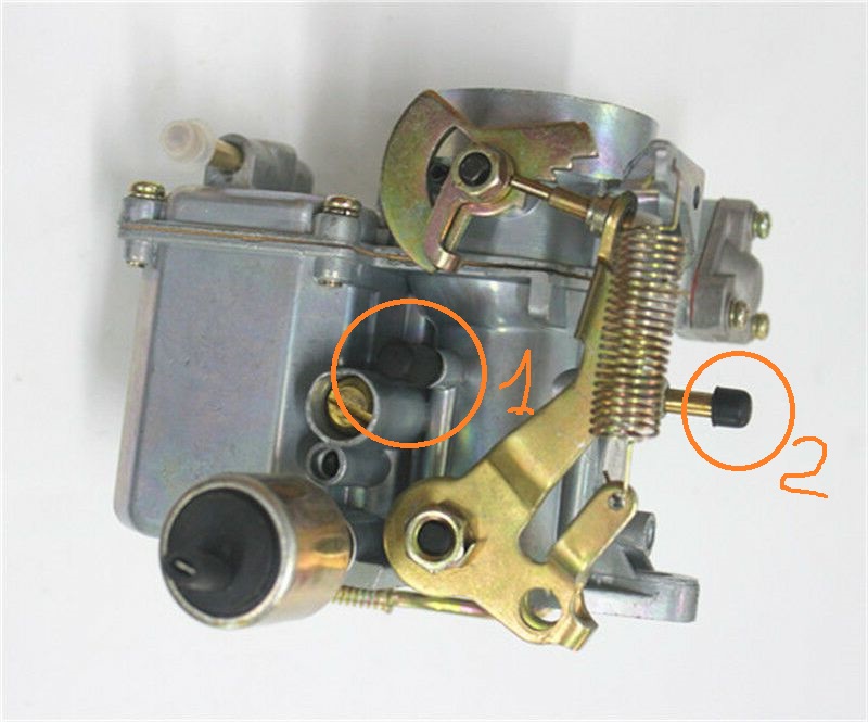

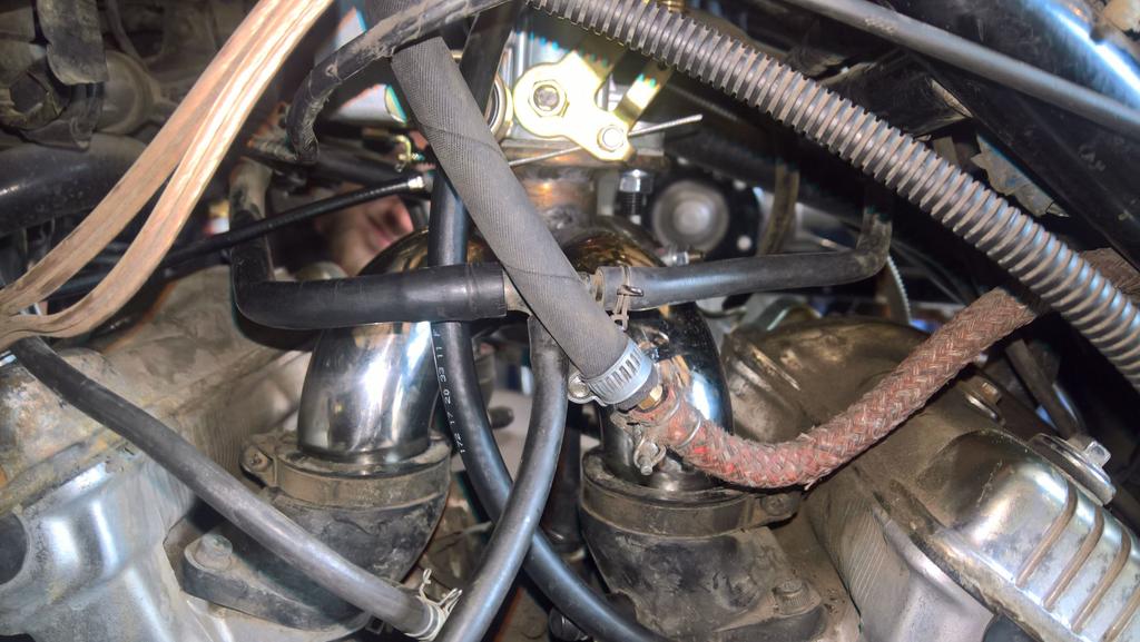

  1. There is an opinion that 1 it is necessary to connect to the sensor of absolute pressure of XVZ, and port 2 to ventilation of crankcase gases.
  2. Hi! Prompt what is done by tubes 1 and 2? There are no instructions in Russian (

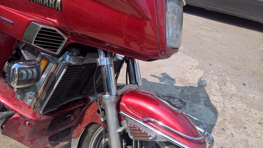

  4. Protection of feathers of a fork. A leg from a table and arms of turns.

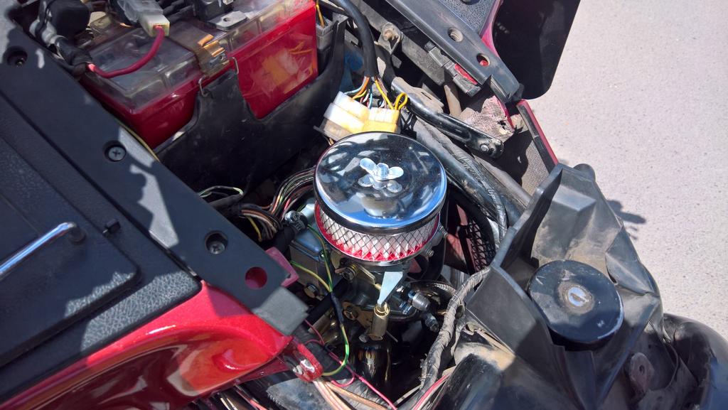

  5. It was passed by 100 km (a photo 1) on the route and 10 around the city (foto2). Main Jet 140. On it I will also stop. Goes well, about 170 km/h dispersed and there was a gas reserve. [ATTACH=CONFIG]116960[/ATTACH][ATTACH=CONFIG]116961[/ATTACH]

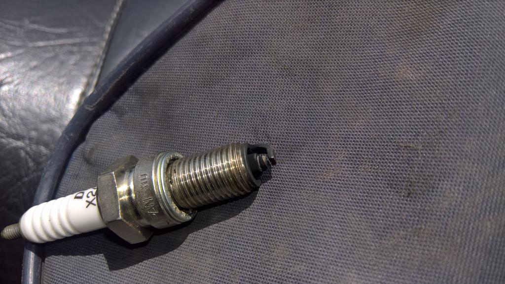

  8. Original main jet 127.5 I installed 150. Motorcycle worked well. Later check the spark plugs. Fuel consumption will report later.

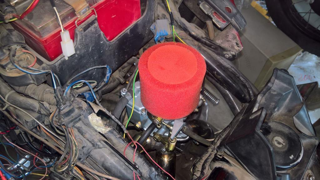

  10. Stainless steel welded intake manifold. The carburetor is not yet configured. A motorcycle often stalls when you add gas. Drove 8 kilometers to the garage. With a fully open damper, the motor worked at 5000 rpm.
  11. Solex 34 PICT 3
