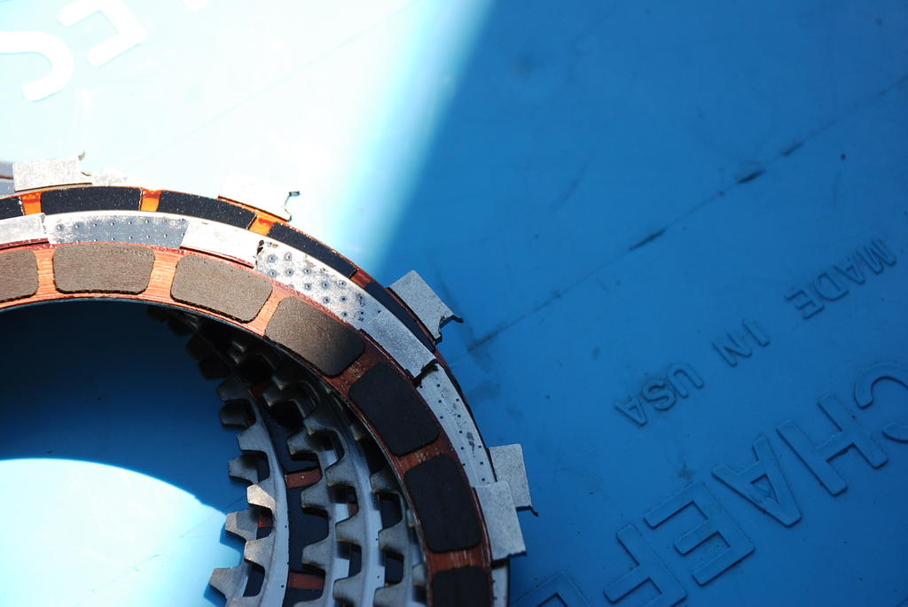

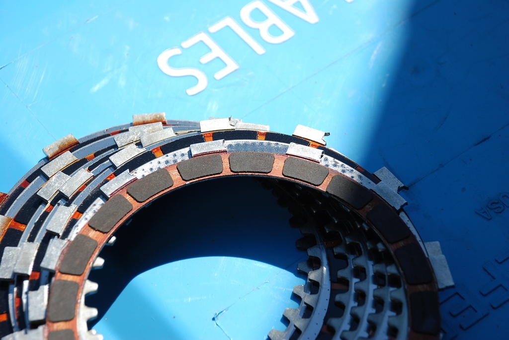

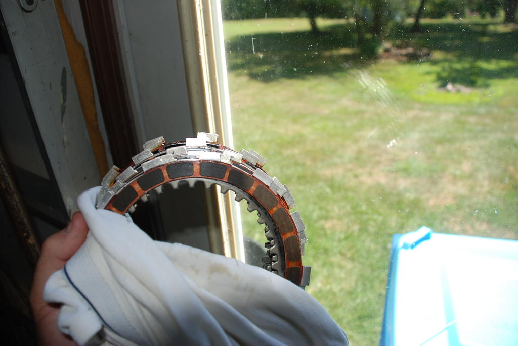

Started taking clutch hub off for inspection of shift drum assembly effort stalled do to lack of specialty tool (clutch hub holder) but after removing clutch plates I found this damage (see photo)could that be making al the racket
yeah there is a lot of slop there but my pin is not not moving like the one in the video will grease that all up tomorrow ,then if that does not fix problem on to the shift drum linkage!!!!

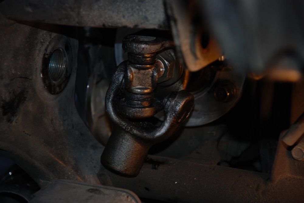

U-joint replacement on 2nd gen
crowrod replied to stereomind's topic in Royal Star Venture Tech Talk ('99 - '13)
Yes, that includes the yolk, all you should need is the the universal. I saw them on ebay last year for $18.00 u.s. I think the Venturers web site has a cross reference chart for what will fit here it is [TABLE] Venture U-joint Cross Reference [TR] [TD]Manufacturer[/TD] [TD]Part Number[/TD] [/TR] [TR] [TD]AEC[/TD] [TD] 1064 [/TD] [/TR] [TR] [TD]Falcon[/TD] [TD] U392 [/TD] [/TR] [TR] [TD]GMB[/TD] [TD] 220-0028 [/TD] [/TR] [TR] [TD]Neapco[/TD] [TD] 1-0028 [/TD] [/TR] [TR] [TD]Perfect Circle[/TD] [TD] 1500 [/TD] [/TR] [TR] [TD]Precision[/TD] [TD] 392 [/TD] [/TR] [TR] [TD]Rockford[/TD] [TD] K1500 [/TD] [/TR] [TR] [TD]Spicer[/TD] [TD] 5-1500X [/TD] [/TR] [TR] [TD]TRW[/TD] [TD] 20128 [/TD] [/TR] [/TABLE] -

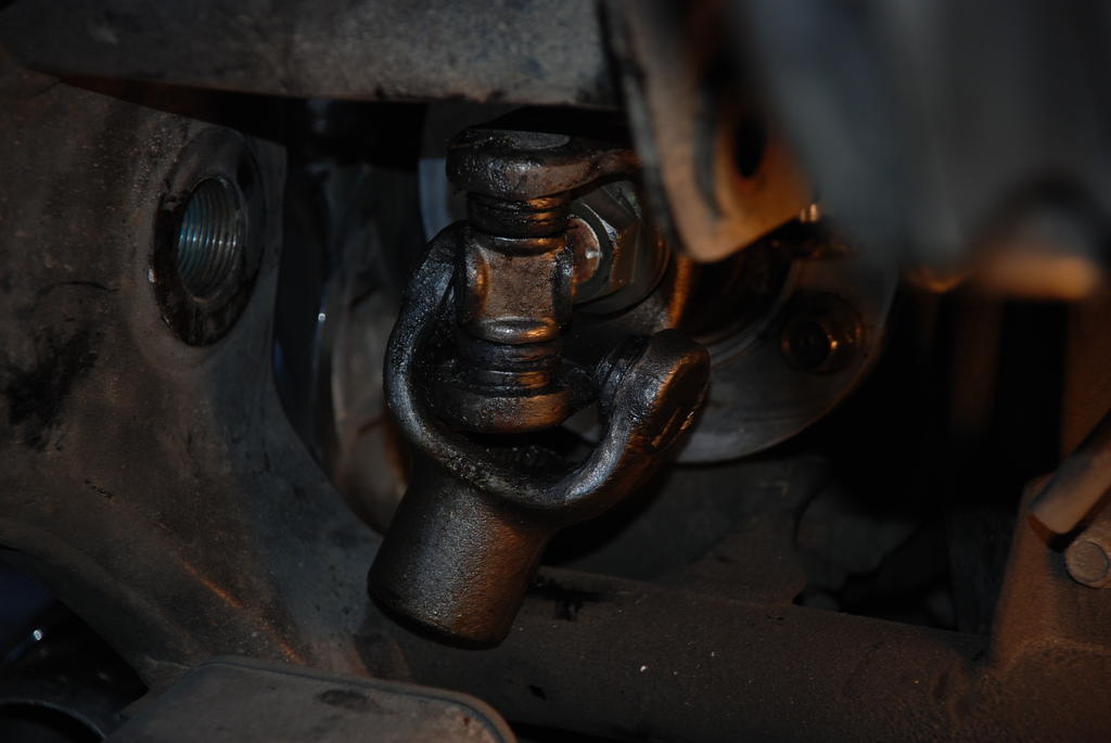

Sorry but that is not correct. from my experience swing arm must come off to service u joint. -
