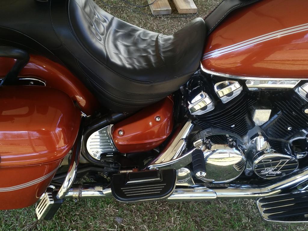

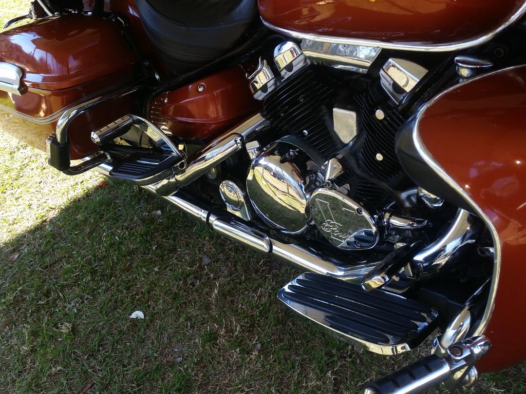

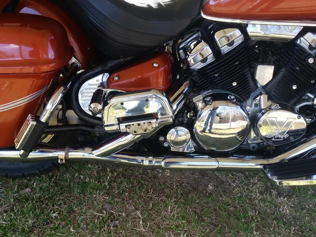

While I was doing the new tire on the rear.. U decided to try to clean my rear wheel... nothing worked so I wet sanded it using 1500 grit paper... cleaned it up decently.. but then I decided the final gear drive looked terrible.. so I put some Amsoil Heavy Duty MP Spray on it... wiped it off while wet and the results were amazing. I then used it on wheel and whole drive shaft... I have the silver color back. I don't think a brillo pad or anything else could come close to what this stuff did... plus I think it will protect it from rust and make it easier to clean in the future.. so 3 thumbs up for this stuff.

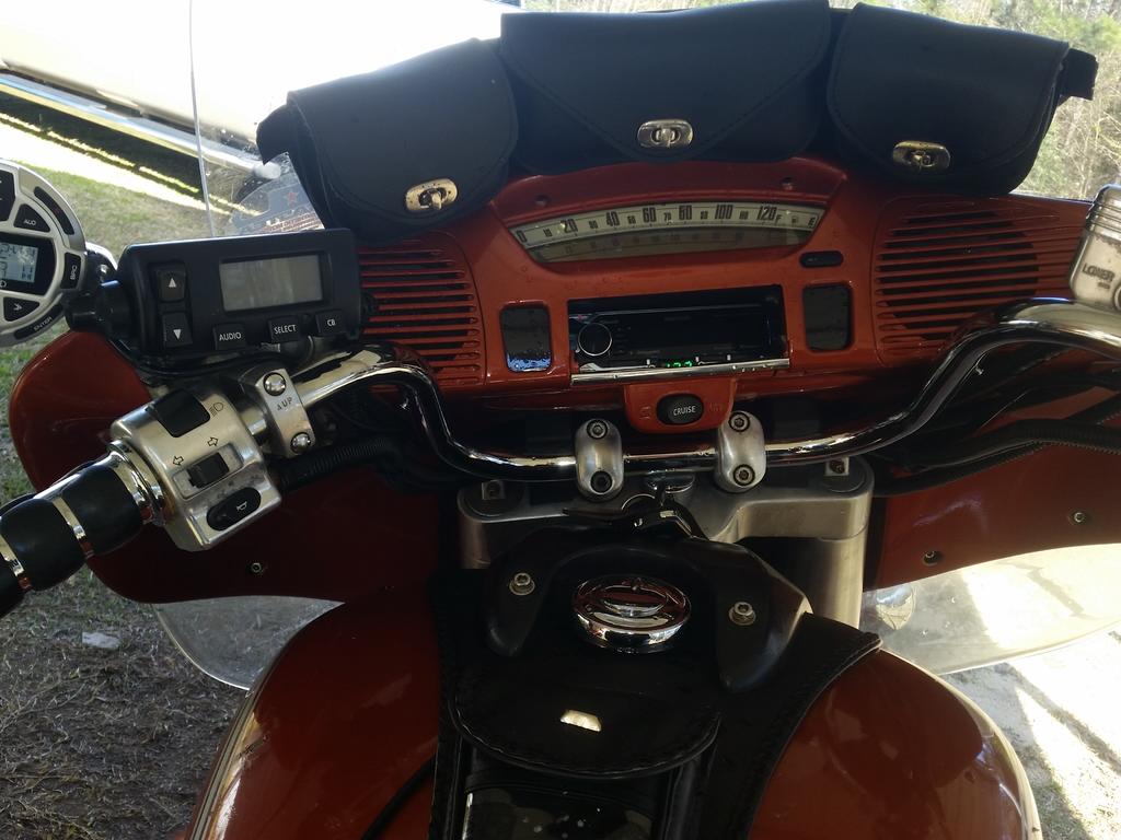

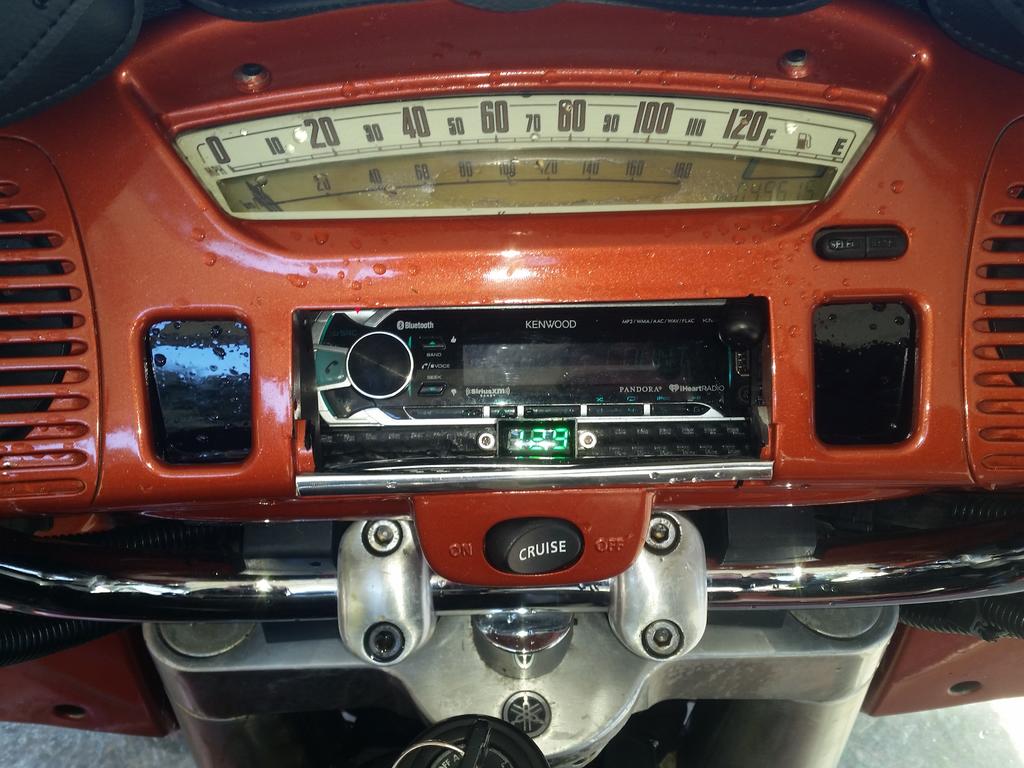

Go ahead and put an aftermarket like I did... Kenwood deck with bluetooth pandora and usb...

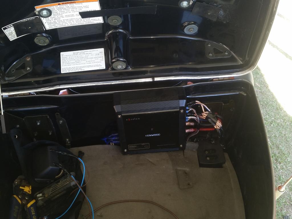

Just installed a kenwood excelon amp 50x4.
JBL 4" up front
Polk 4" in rear
Still have intercom and cb capabilities with helmet.
