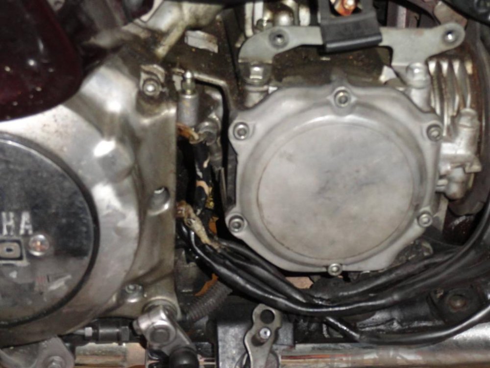

A couple of weeks ago, I started to notice that my 89 had started to mark it's territory with engine oil on the garage floor, and it looked like it was under the middle gear cover (the usual spot). Yesterday Barb and I went for a ride, and when we got home, I put it on the center stand with newspaper under it. I pulled the left side cover off and ran it for a few minutes, and it left a spot on the paper, but I really couldn't see any fresh oil anywhere. I pulled the rubber cover over the clutch slave cylinder and looked down, the stator and the ignition pickup coil wires looked dry. I looked up from the bottom, and couldn't see anything wet. I pulled the left rider's foot peg and looked inside the universal joint rubber cover, and everything looked dry inside ( I replaced the seal here a couple of years ago when I had to replace the universal joint). This morning I took the next step. I've got a middle gear cover that has all the 'uneeded' material removed so only the middle gear bearing is covered. I located it and installed it. I also checked the clutch slave cylinder (dry), the screws that hold the neutral light/gear indicator switch to the case (snug) the shift shaft (dry) and the stator and ignition pickup coil wiring (dry). I started the bike and ran it until it warmed up. I know that the engine oil wasn't hot yet, but it should have been warm enough to leak. I held the RPMs up for a bit, and also put it in gear and turned over the rear wheel. NOTHING. I looked at the gasket that was on the middle gear cover. It split when I pulled the original cover, but I could see no evidence of fresh oil. Yesterday I did see some fresh oil in the frame under the middle gear, but couldn't tell where it came from. Also I looked over the rear valve cover for leaks. I've got some seepage, but no fresh oil. What am I missing? I suppose I could put the shifter/foot peg back on and take it for a ride. On the 2nd picture, you can see the marks on the exhaust pipe that show evidence of the dripping oil.

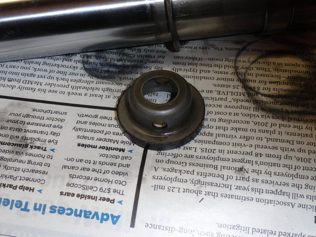

About 3 weeks ago after I installed the Progressive fork springs, it was nice and warm here, so Barb and I went out for lunch and a nice ride back by one of the big lakes near here. We were stopped at a stop sign, and when we started again, I cranked it on in first gear. Things were fine until it got to about 5,500 RPM and then it started breaking up (missing). I shifted to 2nd and it pulled good on all 4 cylinders and then started to miss again when the engine got to about 6500 RPM. The strange thing was it seemed like it was missing on all 4 cylinders randomly. I tried it several more times and it still had the problem and I started to think that it had water in the gas. The last time I filled it, I put in non-ethanol gas, but I thought everything was fine and I was pretty sure that I'd run it through the gears after gassing it up a couple of times. When we got home, I drained one of the carburetors into a can, but couldn't see any water in the fuel. I pulled the fuel filter, and there was no water there either. I changed the fuel filter because it'd been in there a while, but afterwards, it still ran the same. I thought about it for a couple of weeks ( the weather wasn't too good) and decided to drain the tank and put in fresh gas. I drained the tank almost completely and put in 2 gallons of fresh 90% gas/ethanol. When I went to start it, I found that the battery had bit the dust. I ordered a new battery and finally got my old one to accept enough charge to go for a ride. The bike still missed at higher rpm at full throttle. Before the new battery arrived, I figured I should check my charging system. Normally my 89 measures about 14.5V, but now it was reading about 13.95V. The bad battery almost acted like it had high resistance, so I reasoned that the voltage regulator was switching too low because of the higher charging spikes, or higher ripple. Seeing that I hadn't found water in the gas or bad gas and it was all 4 cylinders I started wondering if I had a TCI going bad. I'm using the stock TCI, but I also have one of the Dingy specials on the bike also, so I could switch to it. First I decided to try the new battery. Maybe the pulses on the charging system were doing something to it? Not likely but maybe. The battery arrived last week, but the weather wasn't great and I was busy with another project anyway. Today it got up to about 50 degrees, so after church I took it for a ride. When I cranked it on it pulled up to the red line perfectly, so that proved to me that the bad battery was causing the miss. I'm glad it did so I didn't have to get serious to find the problem.

Jason, Thanks for your recommendations. While I was replacing a fork seal, I also decided to install Progressive springs. I installed them on my 83 30 years ago, but they're pretty stiff and I didn't want the 89 anywhere near that stiff (yes, I've got too much oil in the 83). When I set up the 89, I used a 7/8" spacer, and 360cc of 10wt. oil. I have about 2" of sag. The oil measured 9.5" down from the top of the forks. The bike rides just a bit harsher than the OEM setup, but after about 10 miles it was hard to notice. When I got to a curvy road (2 up), something that I wasn't prepared for was how much more precisely it steers. Even my wife noticed how much better it was. I'll measure the sag again after the springs have time to settle. Frank D.
