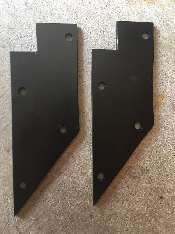

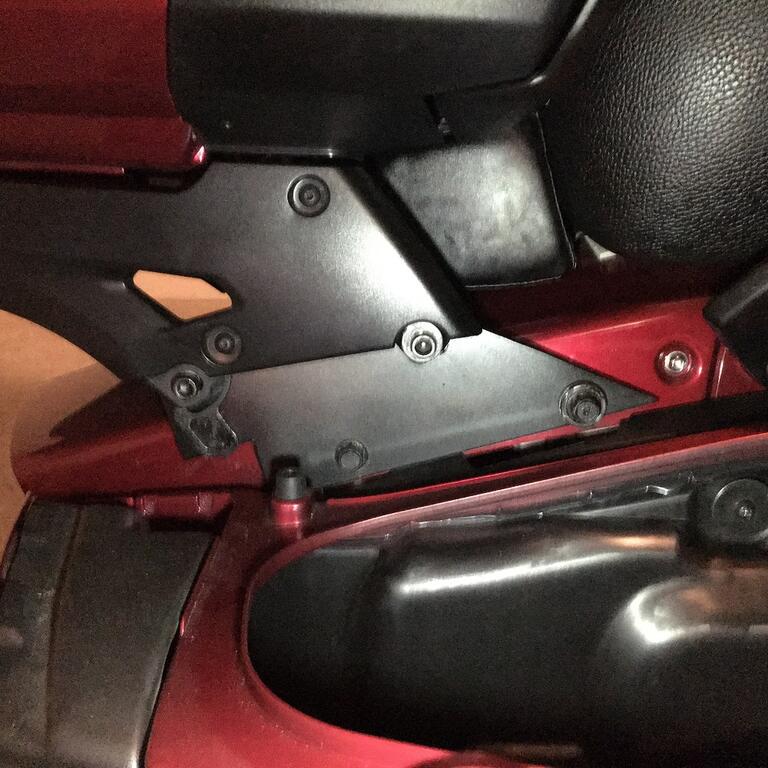

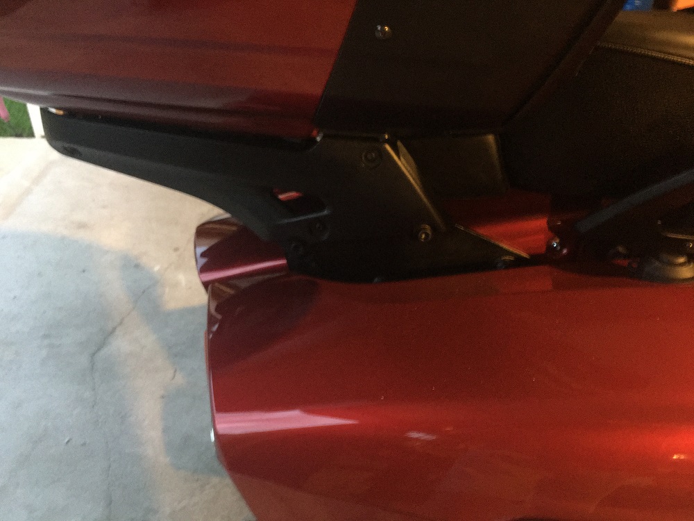

Once I put a driver's backrest on my 2018 Star Venture my wife had no room on the passenger seat. I fabricated brackets to move the seat back 3". Kuryakyn makes filler pads that are made for the Indian to fill the gap after moving the Indian trunk back. They work perfect for the Venture. You will need two pads stacked on top of each other and siliconed together. ($26 each)I hollowed out the bottom pad about an inch to allow the wiring to have some slack. The holes in the bracket are 2.5" above the original holes and 3" to the rear of bracket. The bracket is aprox. 11"x4" and made of 1/4" aluminum plate. It has been spray painted a satin black. (Pics attached) I also added Corbin seats because the stock seats were very uncomfortable on long rides. (optional) My wife and I are extremely pleased on how the project turned out. I also raised her footboards up 1" due to her legs hitting the saddlebags. I used the aluminum plate to make 1" tabs. I have included pictures and will be glad to answer any questions. I was about to sell the bike after only a month until I came up with this solution.
