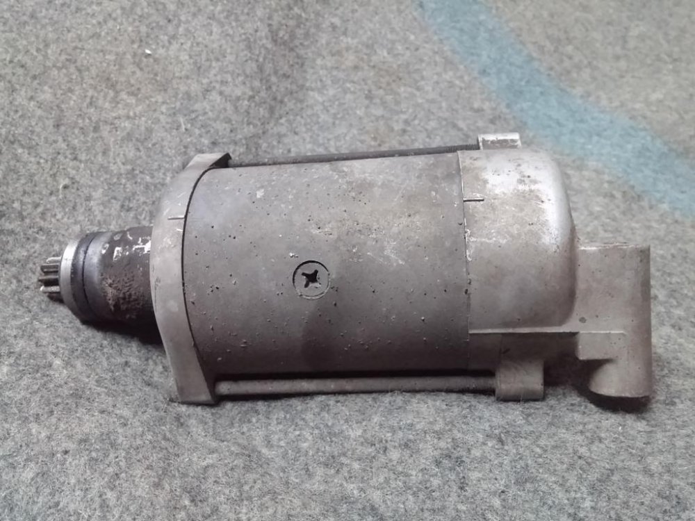

  21. you can tell the difference real easy.On the case of a two brush starter you will see two Philips screws on the outside of the case.On the 4 brush starter you see nothing.
