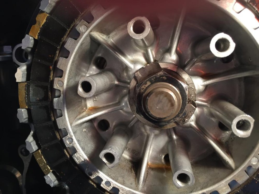

  1. Thanks Goose. I believe you are correct on the main nut and locking tabs. As mentioned the nut was loose and the locking tabs were not folded over. This was most likely the root cause. Now that I know what I'm doing I will go back in and double check everything. As as far as the safety switches, this was just me be so absorbed in solving my clutch problem that it just slipped my mind. Again, thanks for everyone's help.

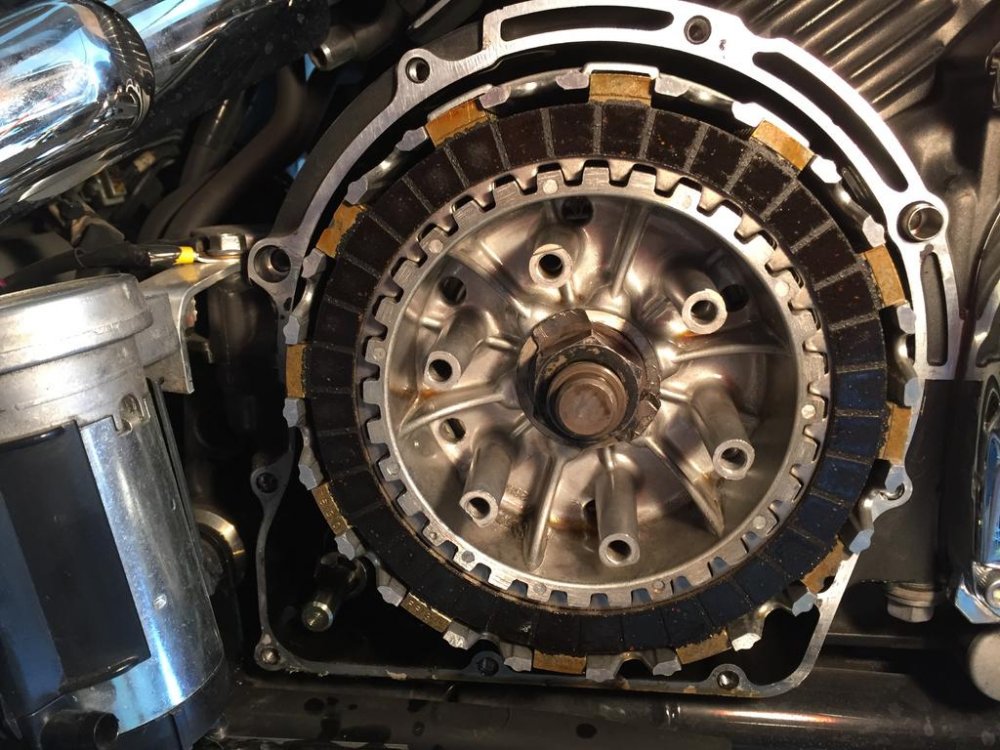

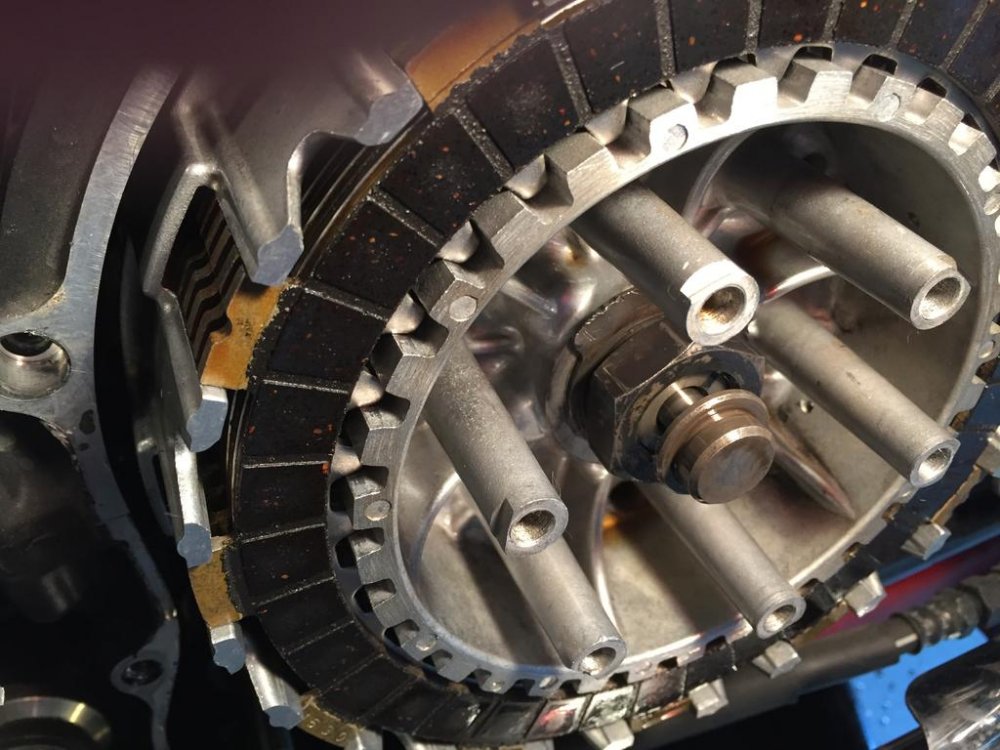

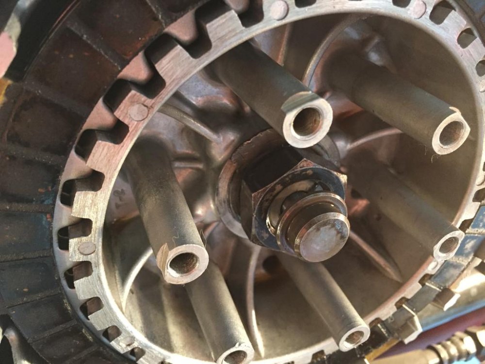

  7. Replaced the Slave, bled the line and pumped it up. The same conditions exist that I had before I replaced it. I'm back to square 1 where the Clutch lever will not pull in and disengage the clutch. As Goose suggested I pulled the clutch cover off along with the pressure plate. The pics show what I see. The large nut was loose, about half way out. Please look at these and tell me what you see.

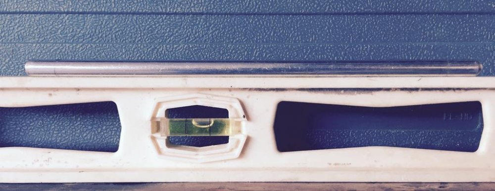

  8. It may be an optical illusion. Here it is on my level. It's straight. My Slave Cylinder will deliver tomorrow. [ QUOTE= V7Goose;988337]Yes, it would take a LOT of pressure to push that rod to move the pressure plate - no way to do it by hand. I cannot really tell from your pictures, but something doesn't look quite right on the bottom left one - almost like the end of that rod is bent down? Be sure to carefully check the parts breakdown for all the specific parts and the order before you re-assemble. Goose
