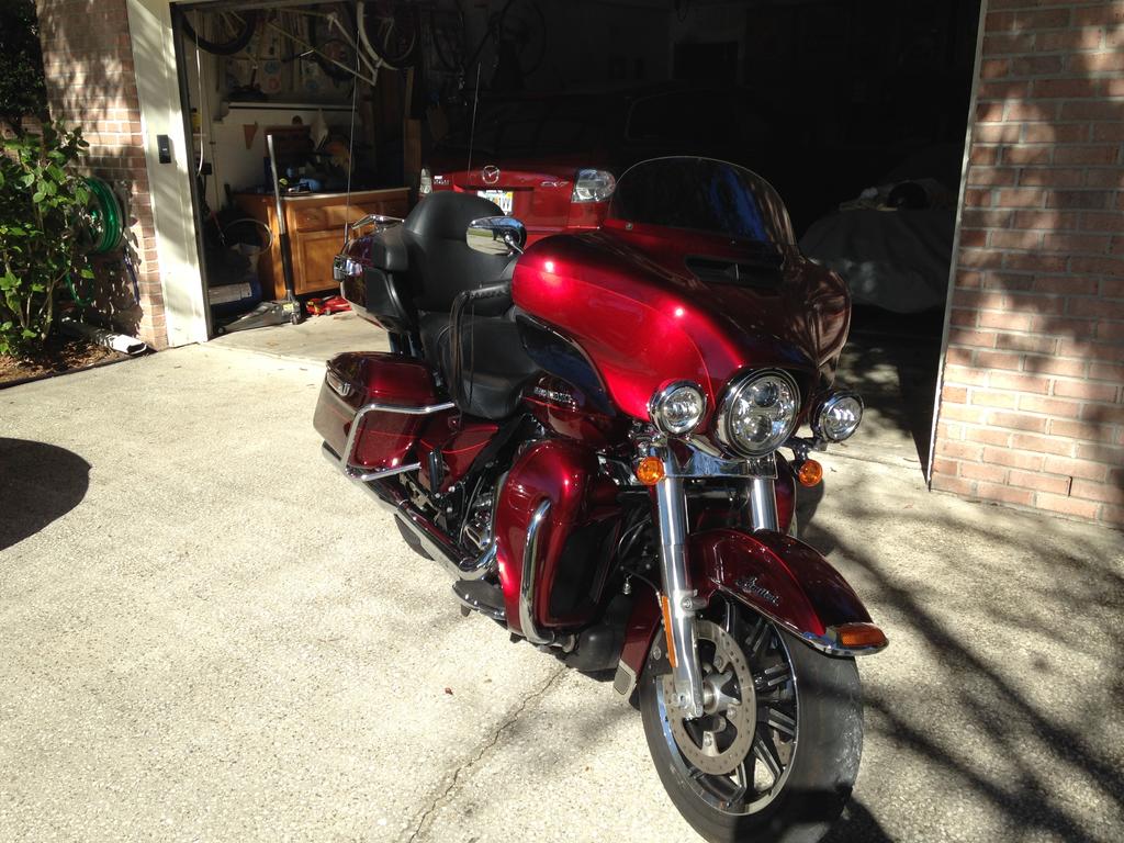

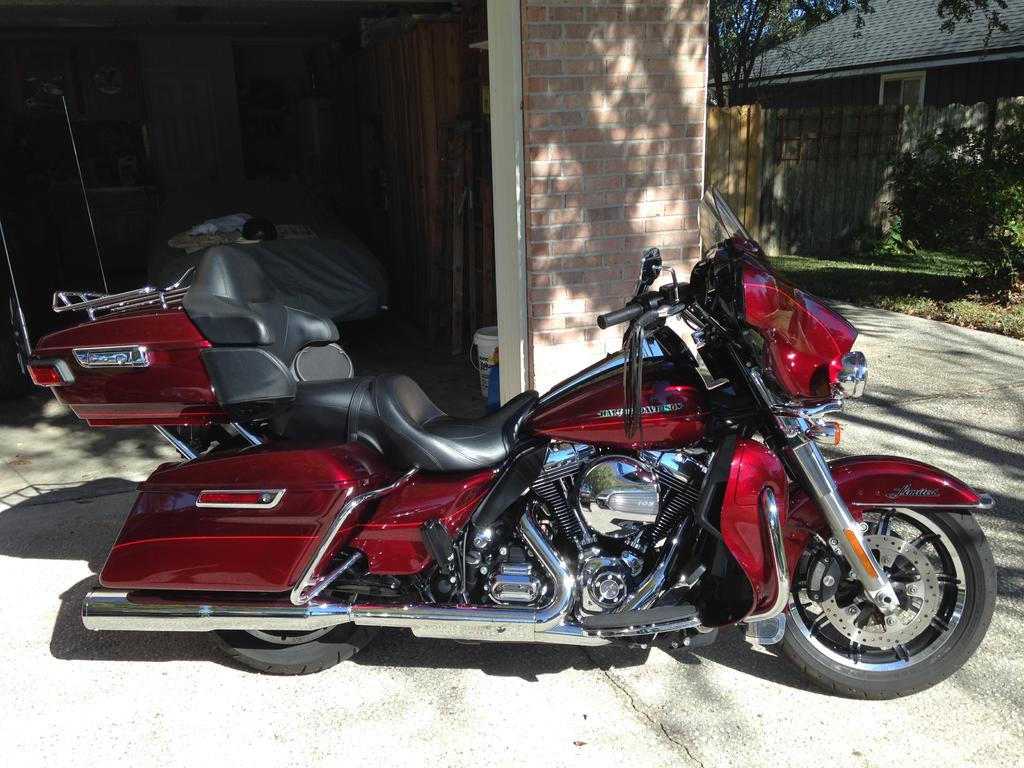

  3. As promised, here are some pictures of the new bike. ,,
  4. Last October my beter half and I rented a Harly Road Glide Ultra Limited when we were in Vegas. This was the first big Harley I had ever ridden, and I was impressed. Long story short, I have been looking at Harlys ever since. I found a 2016 Electra Glide Ultra Limited Low I couldn't live without. Sorry guys. The Kool-Aid was just too good to pass up. Pictures coming soon.

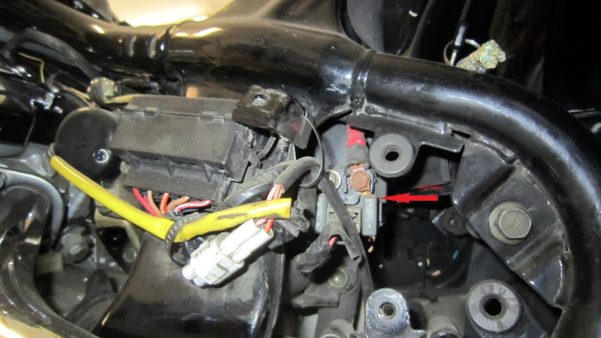

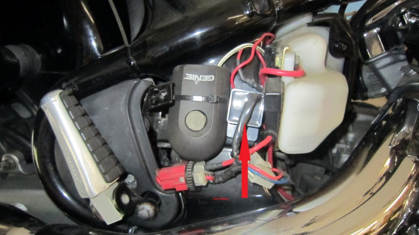

  16. Here are some pictures of my 97. The extra wires under the seat are for the LED lights and my fairing. The start relay is on the left side behind the passenger foot peg. The arrow is trying to point out the fuel pump The arrow is trying to point out the turn relay The arrows are trying to point out the my LED/Fairing wiring The arrow is trying to point out the starter relay I hope these pictures help. If you join the site, you'll get access to the Tech Library that has the complete manual for the bike including wiring diagrams. It would be the best $12 you ever spend.
  17. Zero, The guy you got the bike from was a true "Backyard Mechanic". Looks to me like the starter relay is from a car or another bike. It doesn't belong there. The other wiring under the seat would take some time to figure out. I have no idea why that relay is mounted under the seat. If it's not some sort of add on, it should be under the side cover near the fuse box. I have a 97 RSTD I'll take some pictures and post them. Just remember, "There's smoke in them wires, and the idea is to keep it there!"
