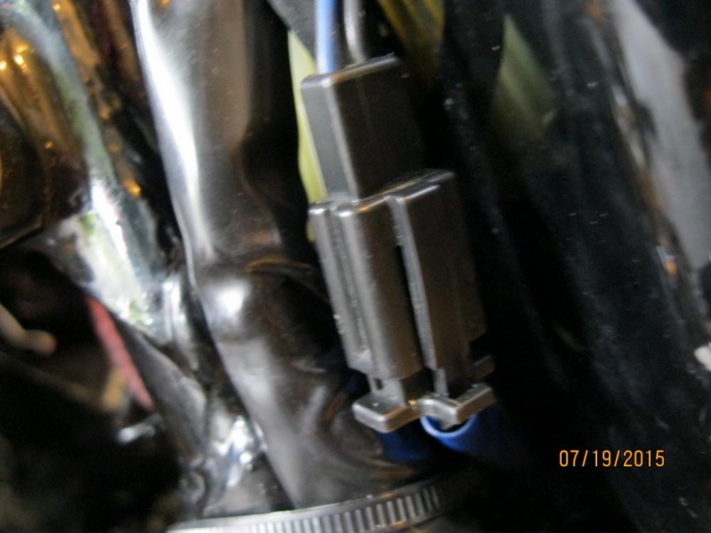

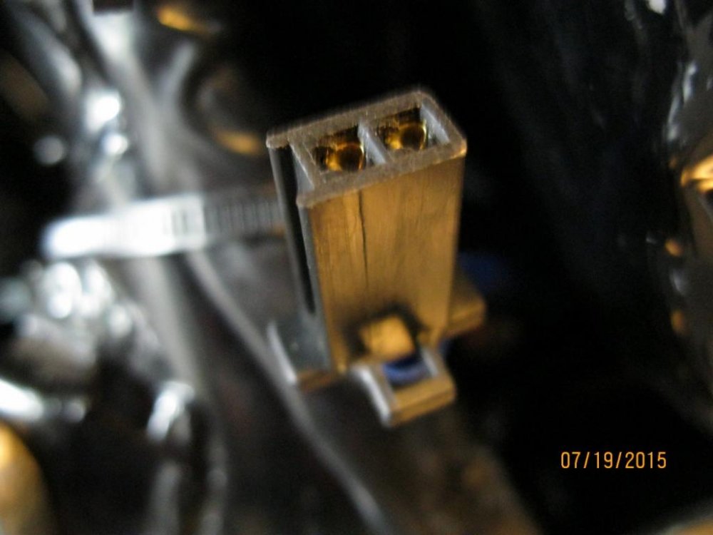

Fuel Pump Connector
Donvito replied to Donvito's topic in Venture and Venture Royale Tech Talk ('83 - '93)
It has two wires with bullet connectors. -
I bought another fuel pump because mine was starting to fail but since I cleaned the points it's been working perfectly. Even so, I would like to carry a spare with me that I can plug in if needed. I would like to know if the original wire connector is available to purchase so I can plug in the new pump. I'd prefer not to replace all the connectors if I don't have to. I need the piece in the 2nd picture. Any help is appreciated.
