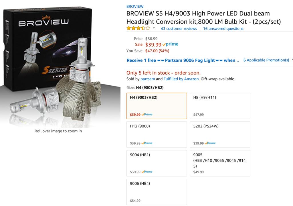

Anyone have experience (good or bad) with these bulbs? Assume this fits 2008 RSV? Is this is a good price?
