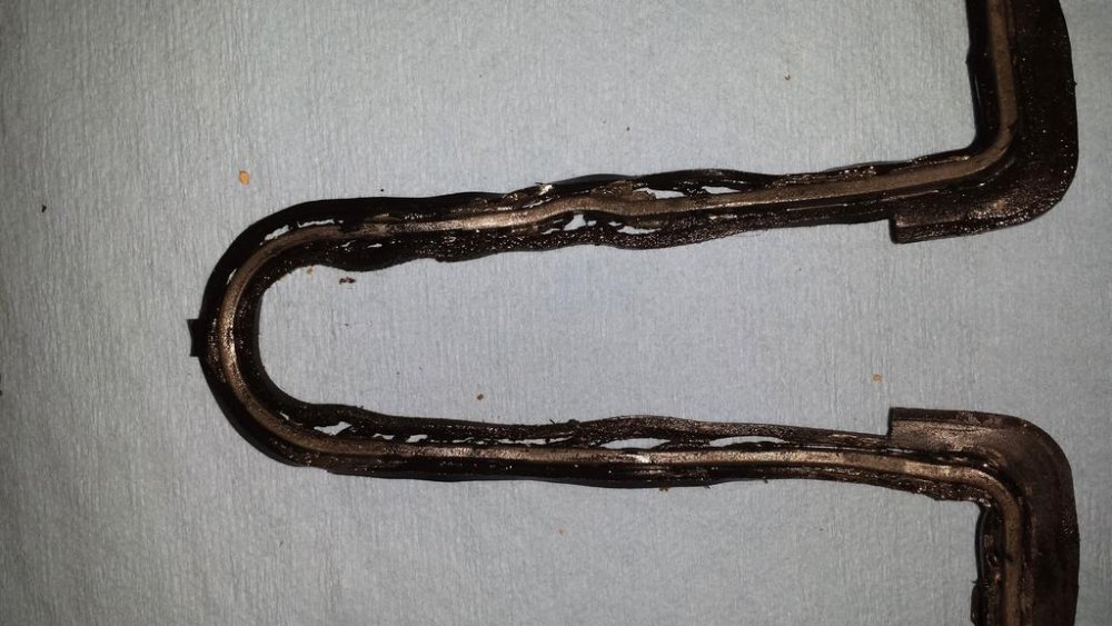

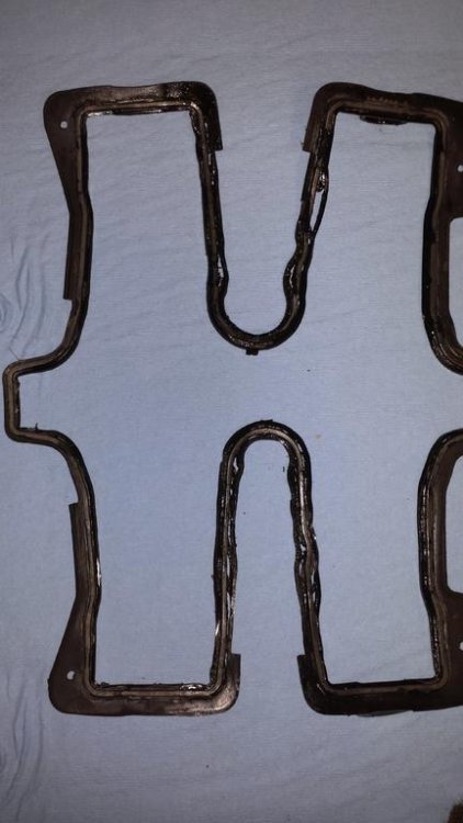

  • State/Province

  10. Update, I think I found the problem with my gasket. I used orginal yamaha part. I did not want to buy the bolt grommets, just to pricey,$9 ea.( I can't under stand why they are so high, the ones for my previous GoldWing were only about $3 ea. and still are. Used a suggestion from Tech section about using washer. Just checked I have a thinner washer on the 1-3 covers, the ones on the 2-4 are twice as thick! Therefore, I created the problem!! Going to do some research to seeing if I can find a better price on the grommets. Thinks for all the input,
