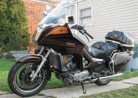

After the last few weeks of crappy rainy weather we finally got a good one . and just in time too. sky_doc17 steered me in the right direction again and as usual he was spot on. after installing the needle shim kit in the 83 , a quick reset to 3 turns out on the air needles and a re-sync at 3500 rpm. I know I'm now getting the best mileage that I can possibly get. the bikes running AWESOME. and i even put a few hundred on her today . Sky-doc17 is the man , and we wish him a speedy recovery. All in All this has been the best day this year, and I even backed the bike into the garage , instead of pulling it up on the lift because I can now say its ready to ride tomorrow and I don't have any thing left to fix on it. its been a long time coming for this old lady, but shes finally treating me right . 2 up on the freeway 70mph, 3200 rpm and rock solid. life is grand. I think I'm in love again. but don't tell my wife .

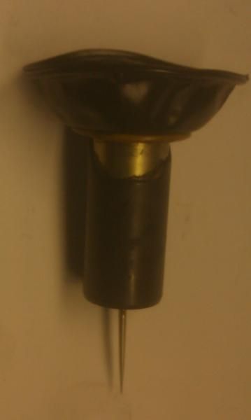

thanks to skydoc_17 for enlightening me on the years that will work. it seems that only the 83 to 85 carb slides will work, thank you for those who offered up the gen 2 models but the mk1 has 28mm slide bores and the mk2 has 32mm. so the hunt goes on. I lost a couple of flea-bay auctions on some complete used carb sets but keep getting outbid at the last min. . If i do manage to get a set and ne1 needs parts from them just let me know. until then the hunt continues.

Needed 1 used first gen carb slide. If any one has 1 old but usable carb slider for an 83 first gen Smaller bore than the 2nd gen. , can you PM me. skydoc_17 put me on to a problem i was having and sure enough he was dead on (as usual ). I had one slide come loose and was not opening all the way. superglue repair and carb sync and its a new beast. all the rest of mine are OK but the chipped up one , and I hate to run it (even though it runs great now) with it knowing its condition. let me know. thanks. Maindog
If any one has 1 old but usable carb slider for an 83 first gen Smaller bore than the 2nd gen. , can you PM me. skydoc_17 put me on to a problem i was having and sure enough he was dead on (as usual ). I had one slide come loose and was not opening all the way. superglue repair and carb sync and its a new beast. all the rest of mine are OK but the chipped up one , and I hate to run it (even though it runs great now) with it knowing its condition. let me know. thanks. maindog.
