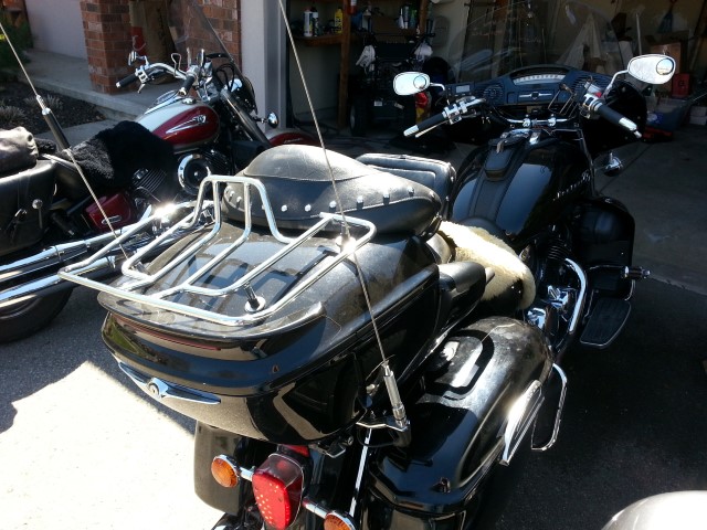

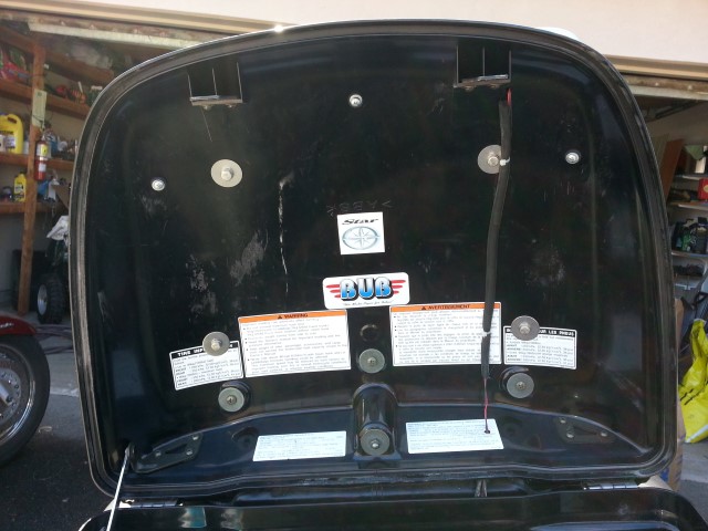

Here ya go~........and, yes.....it was a LITTLE spooky drilling through the trunk lid.....but it's one of those "measure twice......'er FIVE times, cut once" thingies!! :-) -

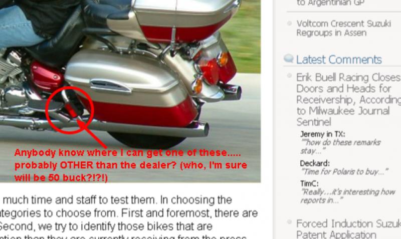

Help! Anybody know where I can get a replacement reflector for the rear "crash bar" that's situated in front of the bags on a 2003 gen two? Probably the dealer wants $20.......I was hoping to find it on a Stanley site (since that's the name on the inside of the black "box")...but, no luck. Any help greatly appreciated.

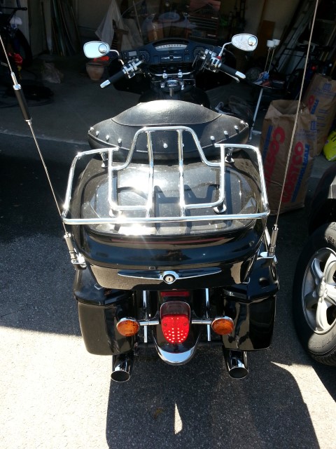

Agreed, Kev. I picked up some stainless washers at a nut and bolt supply house and actually had 8 rubber washers custom cut (for 25 cents each if you can believe it) at another local shop. Fit like a dream......looks amazing........solid as a rock. (I can practically lift the back end off the ground with the rack! OK....that's stretching it a BIT, but not by much! :-) -
