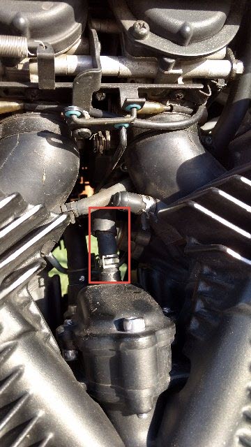

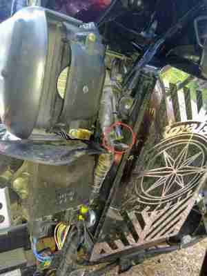

I did rap on the bowls with bike running, but it wasn't standing up straight. However, once I tore into it, I discovered that the hose spewing fuel under the RIGHT lower cowling was actually tied into the RIGHT side carbs instead of the LEFT like most documentation says. So I was in fact rapping on the wrong carbs! Oh well... -

Hey guys, regarding my supposed stuck float (fuel coming out RIGHT carb vent hose), tomorrow I'll be reconnecting the carbs & give the bike another try. Just thought I'd let you know what I've done so far & see if there's anything else I should do before hooking everything back up. Let me know...JR Here's what I've done so far (with the help of videoarizona & lots of Tech articles): Drained gas, pulled petcock (looked good), and checked tank (looked good) Bought new ethanol free gas & added Techron to it...ran for 10 mins, sat for 2 hrs, ran for 10 minutes, sat overnight...same issue with fuel coming out RIGHT side carb vent hose but not as bad as before. I traced that hose back & mine is NOT connected to the LEFT side carbs, but to the RIGHT sides instead...so apparently the stuck float is one of the right ones Pulled surge tanks & found quite a bit of oil...cleaned up & lowered my oil level to 1/2 way up sightglass instead of 3/4 like it was Was going to inject carb cleaner thru carb drains but since I wanted to remove the pilot screw caps & was already this far, I followed Tech Library instructions and removed carbs completely Removed float bowl covers (everything looked pretty clean) & inverted carbs, then blew thru fuel hose lifting each float for a few seconds. Was able to remove 2 of the floats & clean everything thoroughly, but the other 2 couldn't be removed without pulling carbs apart (which I didn't want to do) Cleaned everything I could with carb cleaner Put float covers back on & then injected carb cleaner thru each drain hole & let it sit for an hour. Then emptied & flushed with gas Drained everything again Changed all spark plugs (and air filters were changed a few hundred miles ago) Before reconnecting everything tomorrow, I'll move carbs onto bike & attach fuel hose to them, then operate the ignition to run the fuel pump & fill the bowls...then continue turning key off/on & see if anything leaks anywhere...including coming out vent hose again. Not sure this is valid test without the bike running...but assuming nothing leaks then I'll reinstall everything & give it another try. -

My 2006 RSV has always fired right up & run like a champ. 5 days ago I returned from 100 mile ride where it ran as normal. 50 miles in I filled up with gas & it continued running fine the rest of the way. 2 days later when I loaded into toy hauler for vacation, it started hard & I had to keep the throttle on or it would die. Weird but didn't think anything of it...I should have... I unloaded in the Black Hills & it started hard again. I had to stay on the throttle or it would die. As soon as I started riding I could tell something was wrong. It had much less power than normal but I was able to get on highway & get it to 60mph, but it was missing & sounded like crap. Got back to camp & felt all 4 exhaust pipes. The right rear one was warm, but not nearly as hot as the others...so I changed that plug...didn't make any difference. While it was barely idling, I noticed a fuel smell & found fuel shooting out of some kind of overflow hose under the lower right front cowling. That hose appears to go back up in between the front 2 carbs. What is that hose called? So when I call the Yamaha dealer I can give them some good info. To make matters worse, we're camped in area with no cell service, so have to run into town to look things up! Any idea what's going on? Is a float stuck or something hosed up in the carbs?
