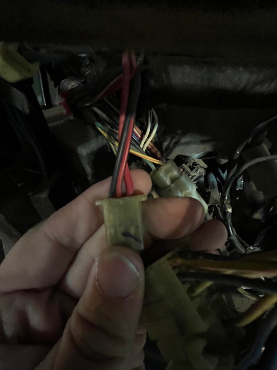

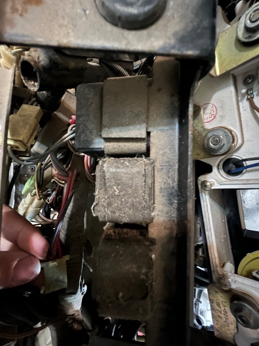

  1. Solved** The plus was originally intended for an audio system which my bike does not have. I found the missing relay hiding in some wiring. I had to fix the headlight wiring as it was messed up from the previous owner but after throwing a new bulb in and correcting the wiring my tail lights and running lights work as they should.

  3. Thanks blueSky, I figured as much.

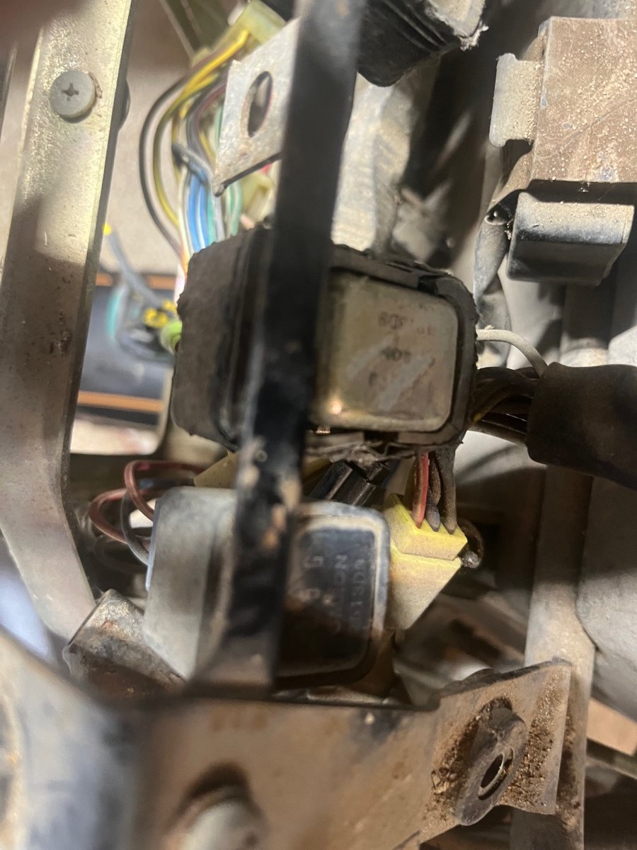

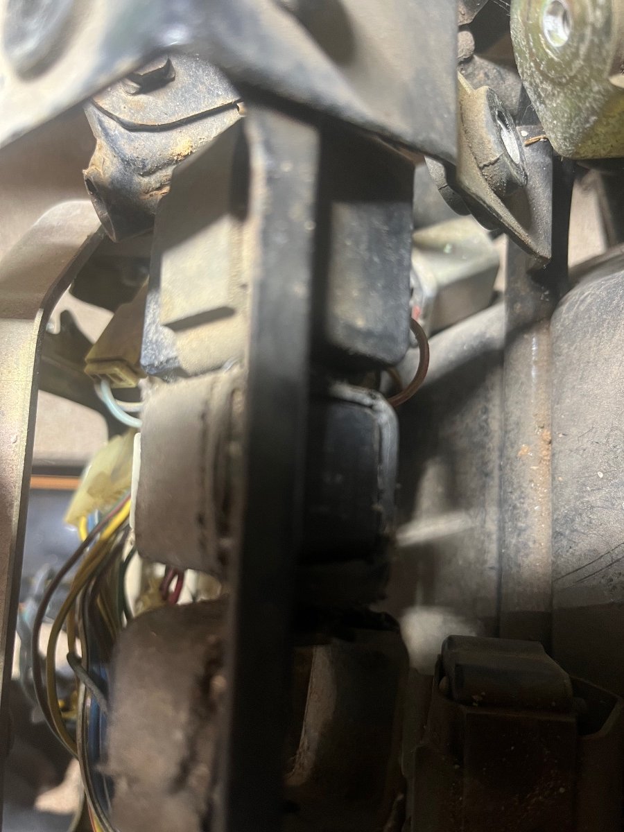

  5. 3rd update. I’m missing a relay of some sort. Not sure which one it is, and the others were not in the slotted space. I replaced them the best I can. If anyone has an idea of which one in need?? I’ll try and find it in the service manual. The pics are from right to left. The 3rd slot is the empty one. I’m thinking the wiring harness plugs in it.
