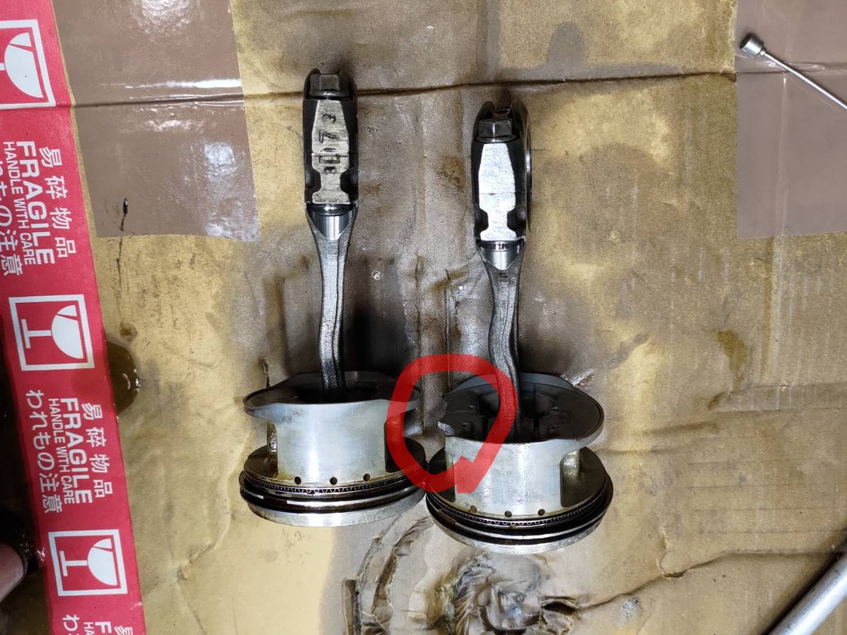

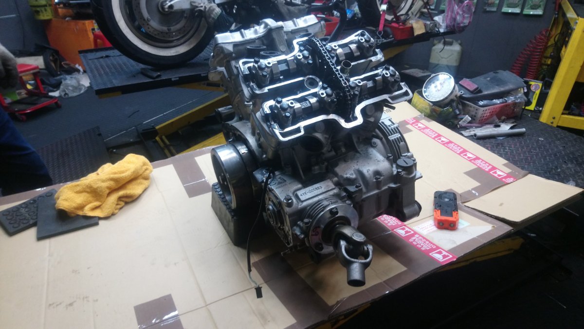

  1. Dear all, The reason of the strange crunckind sound was finally found... Leaking fuel pump together with leaking carburetor made gasoline filled the engine cylinder when engine was in off status. Again when I started the engine,too big inner pressure made the con rod of Cylinder 1and Cylinder 3 bent.....That caused bottom part of piston hitting engine crank case and cracked. And the cruncking sound happened.
