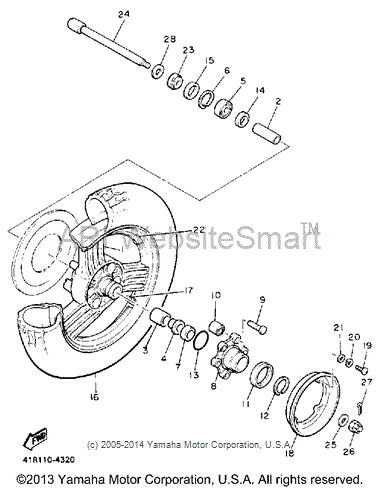

Did you take them the whole bike? If so I'd say they owe you a collar. If you just took the wheel in it's probably in the trunk/back of the truck etc. I try to check every wheel as it comes in the door and place the loose stuff back in the customers hand. -
