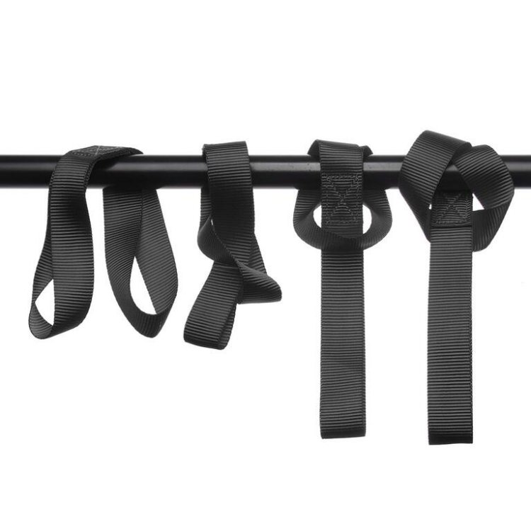

The video is pretty good but I think there are a couple ways to improve what he's doing: 1) I don't like having the ratchet near the motorcycle. I use tie down extension straps on the bike and run the ratchet strap from the extension to the trailer, with the buckle at the trailer end. This is the kind of extension strap I mean: 2) He's got excess strap tied off near the motorcycle. That could flap in the wind and damage paint. Tie the excess off down at the trailer. One more thing, tie down the rear even if it's a single strap through the wheel. If you're in a collision you don't need the motorcycle somersaulting onto the tow vehicle. -
