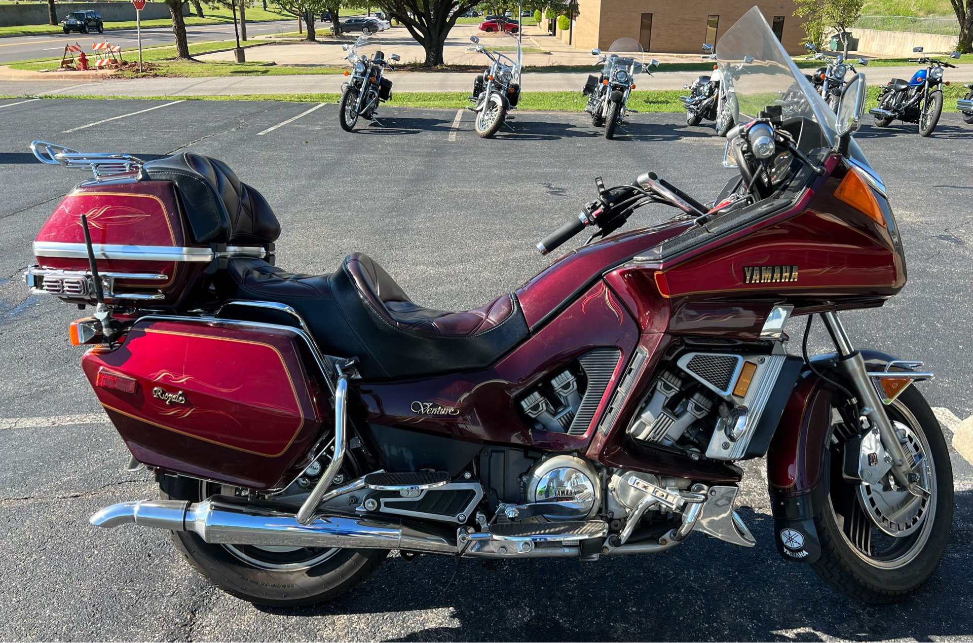

  3. I mess being with Motorcycle riders i have just joined never knew there was such an origination as the Venturers. I'm 69 and have worked almost all my life and have very few friends and the only other biker friend i have is my younger brother he has a new Harley and I have a Harley and this 1984 Venture Royal I'm currently having problems with the turn signals I ordered a new handlebar control for it the return spring in the cancel switch has worn out and will not let the switch return. I don't have turn signals and I have replaced both the 41R-71 RELAY and Hazard Switch AND still don't have TURN SIGNALS and yes, I did check the Fuse on both sides there is power. Wire checking don't have power on the brown wire with white strip at the 41R-71 Relay or at the Hazard Switch and no power on the handlebar switch assembly same wire (B/W).
