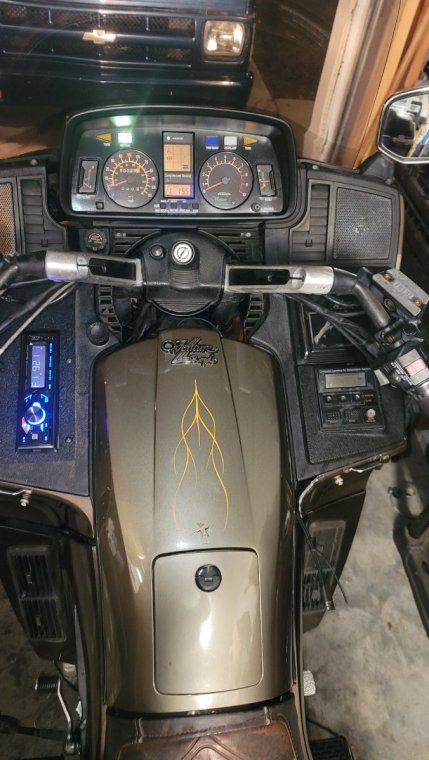

  1. Added a basic radio today and upgraded the speakers to some JBL's. Nothing fancy but works better than the factory did at this point. Now to decide how to maybe get a little bigger speakers or something in the back.
