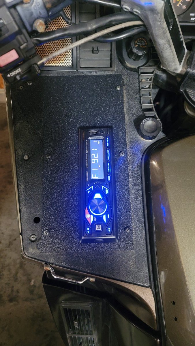

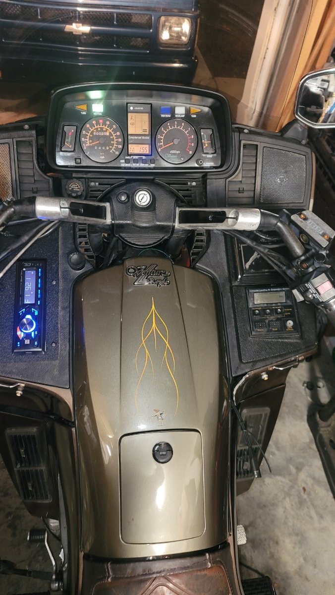

  1. Added a basic radio today and upgraded the speakers to some JBL's. Nothing fancy but works better than the factory did at this point. Now to decide how to maybe get a little bigger speakers or something in the back.
  2. Now just have to get some mufflers/exhaust. Currently doesn't have the slip ons
