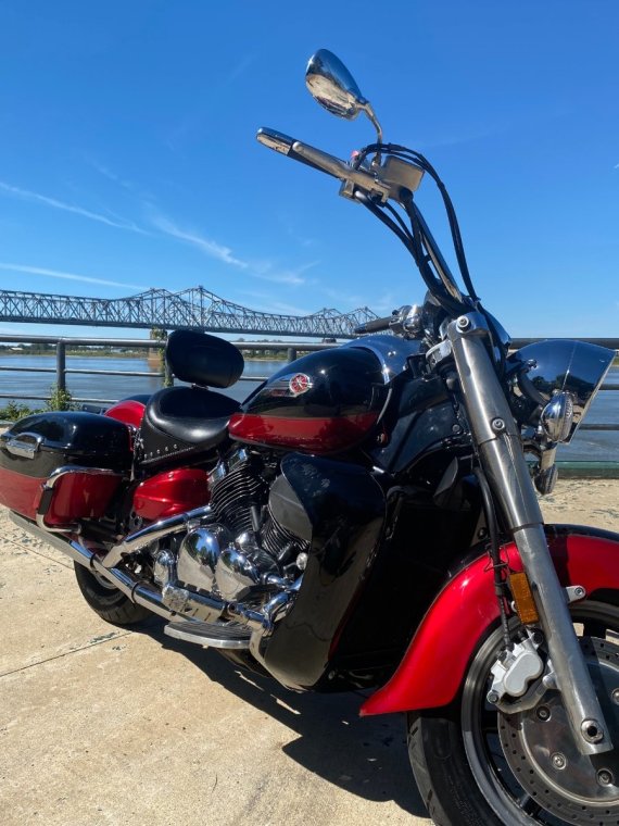

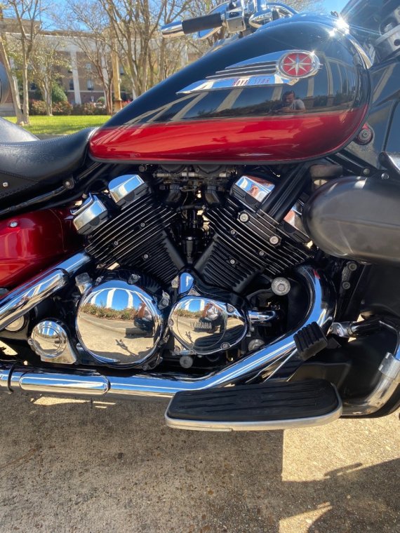

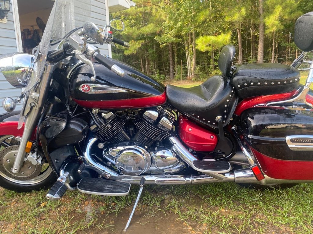

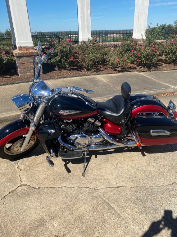

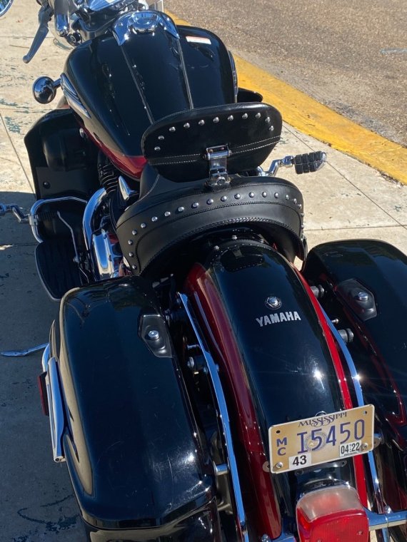

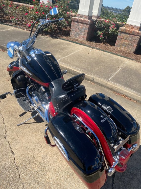

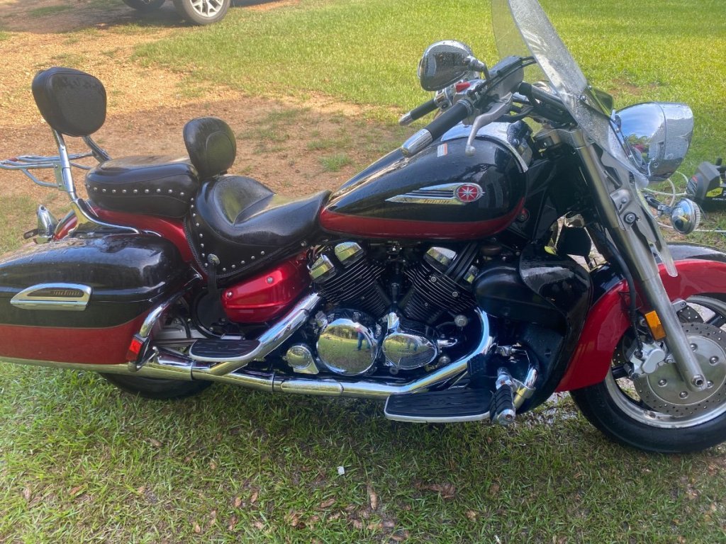

Sorry I haven’t posted lately. Got the regulator/rectify on and it’s charging great. I took about a 200 mile trip to Natchez this weekend. The bike runs fantastic. I might try and sell it. Here’s a few shots for you. -

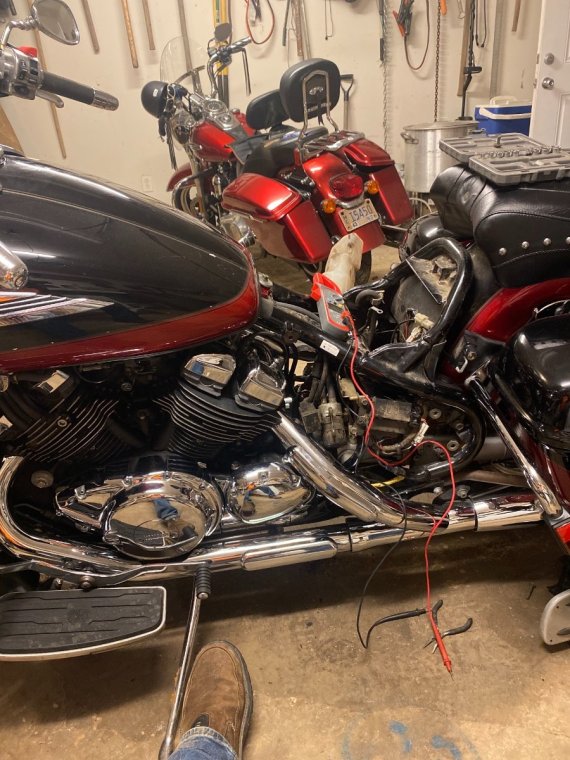

Sorry for the rapid fire questions. I checked all the fuses in the fuse box. And the two 30 amp fuses on this box that I pointed to in the picture. But there is no continuity between the two poles on this box thing that I don’t know what it is. I’m assuming it is the starter solenoid and only connect when the starter button is depressed. Let me check that. -

And…. I checked the red wire from the RR plug to the positive battery cable, it is good. And the same with the black. It’s good to the battery ground. What is this little box that the positive battery lead is coming out of??? I know probably a stupid question, but hey, I’m terrible at electrical!!! -

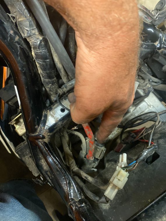

Ok, so I ordered a new to me used coil. And got it firing. Luckily, it was the obvious plug in on the wiring harness. It’s running ok. I’ll probably do the AIS delete to clear up some backfire. But first, I’ve got to clear up another issue. It doesn’t seem to be charging the new battery I put in it. With a little research and YouTube, I’ve checked the stator for continuity. It seems to check out fine. All three wires to ground show OL. And all three wires paired in different configuration show resistance. So next I move on to the regulator/rectifier. Thanks to a YouTube video I was able to run a biased and reversed biased test. It checked out fine, according to the YouTube. Still no charge. Is there anything else I should check. Any help would be appreciated -

Or, if anyone may have their tank off a similar bike maybe you could shoot me a picture of it. It’s the coil outside the frame on top. Goes to the front right cylinder. Where does it plug in. -
Hey everyone. I’m new to the site but need a little help. I picked up a 2005 Yamaha Royal Star Tour Deluxe. I got it pretty cheap, the guy said it had carb problems. He looked at it and gave up on it and let it sit for five years in an open air shed with the tank and breather box off of it. The carbs were locked up, but I disassembled them and cleaned them and got everything freed up and blown out. Reassembled and put them on the bike. But this is not what I need help with. im good with mechanical but not so good with wiring. The coil for the front right cylinder was missing the plug wire so I’ll have to replace it. But also, the wires powering the coil are missing. So here lies my problem. I’ve seen on eBay, used coil harnesses. Most of them appear to run two coils. But the front left coil is intact, with wires going to it. My question is what coil harness do I need and where do I plug it in. There is an unplugged plug in my harness with a red/black strip and white wire. Maybe this is it. And…I don’t understand wiring diagrams very well, so could someone please tell me the location. Thanks
