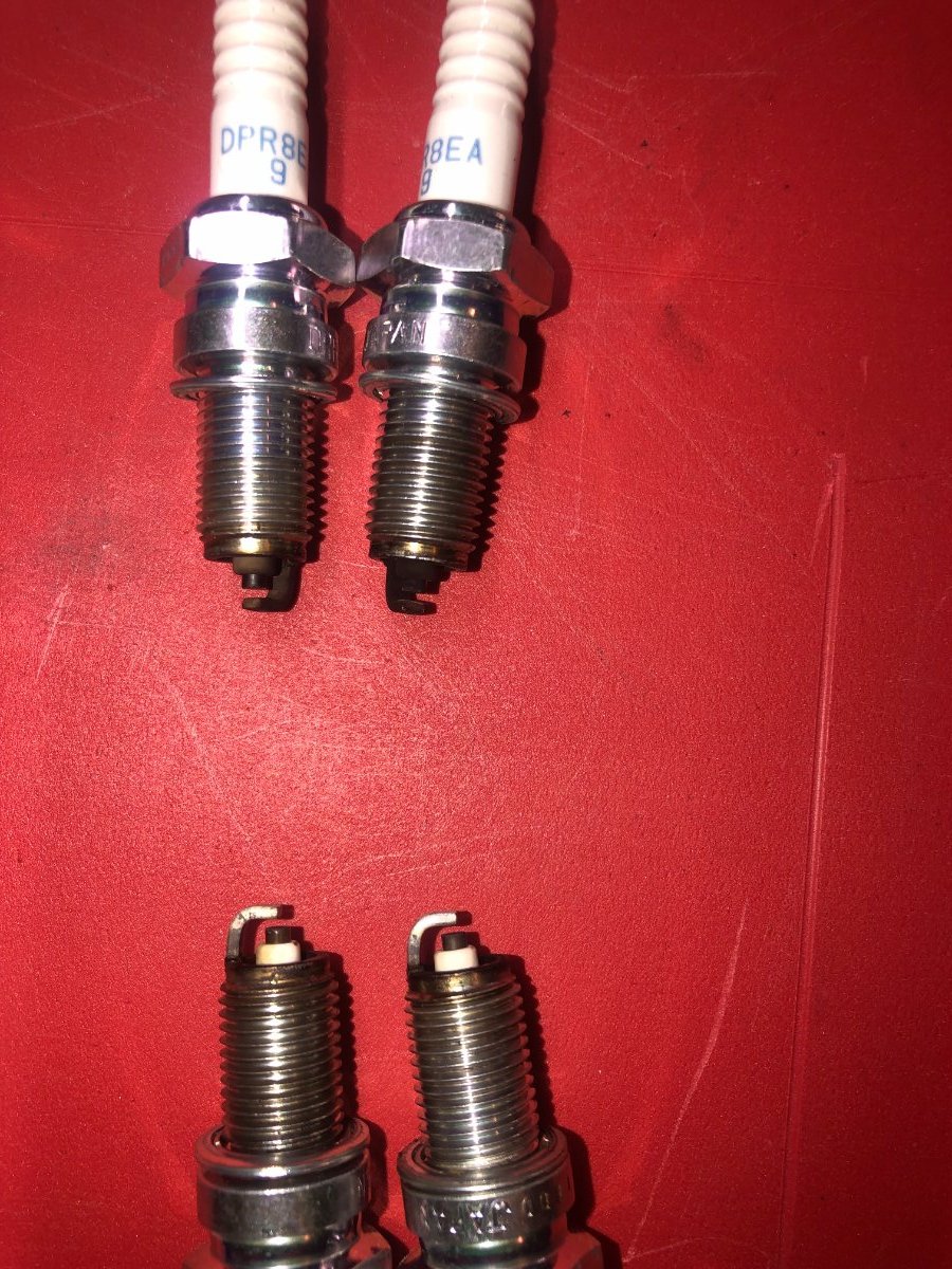

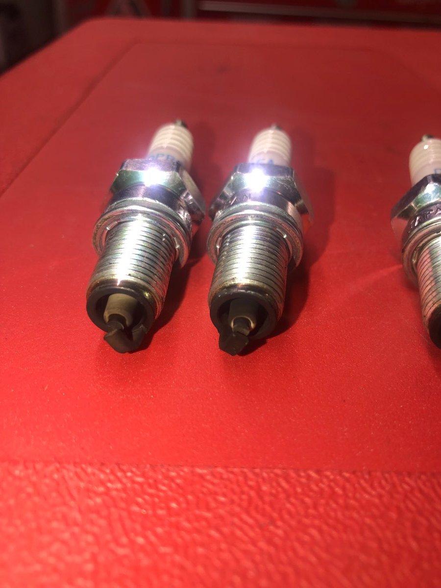

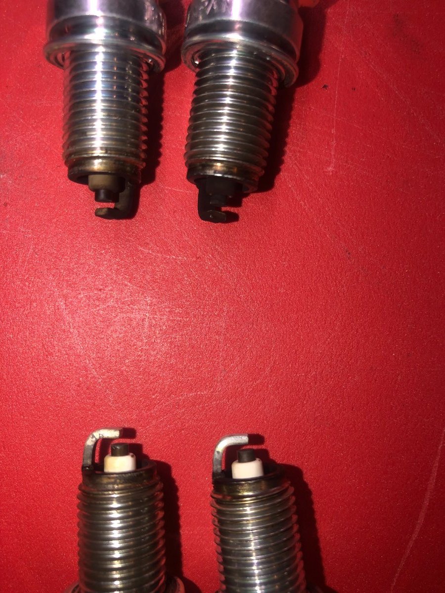

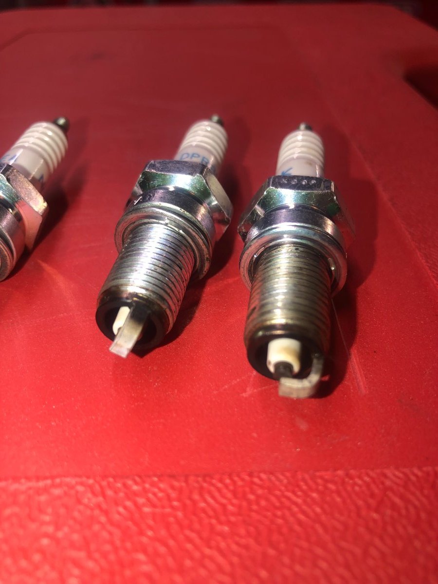

  3. Rear plugs look totally clean. No tan, no black, just like brand new. Front plugs have dark tan to black and look rich to me. Spits black specs out of both sides of the exhaust. Bike stumbles a bit when accelerating from a stop, kind of smooths out if i stay light on the throttle. If i grab a handful it really stumbles then takes off like a raped ape. Front cylinder temp is a round 200 the rear is almost twice that. 380-385. Im pulling out whats left of my hair on this sucker. Preignition maybe? Could the advance be bad? Have the hose hooked up to #1 venturi port. Carbs are synced. Sea foamed the crap out of it and replaced all diaphrams. Stuck an aftermarket fuel filter and changed the long hose out. Maybe clogged petcock? Weak pump? Maybe im overthinking it... Can someone give me a shove in the right direction or at least a place to start? Check timing? Carb disassemble? Thanks in advance...
