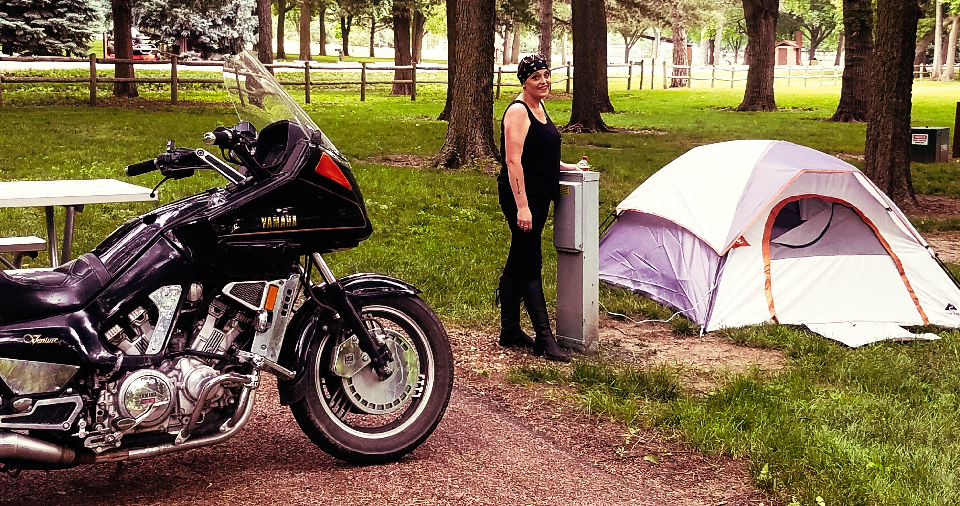

  6. Thank You, I'm very happy to have found you guys, I have a 1983 Venture, that I love, but she need some TLC since her last owner, I hope to both benefit from the advice from this community but also to be able to show the progress made on this project, I'm also excited to be able to leave helpful comments and see the progress of your projects and rides!
  7. Hey, so Happy to find you guys, I came across this 1983 Venture a few years ago when I desperately needed a bike, Picked it up for all of $800, and she ran great until, one afternoon I went to restart her and I got a couple of cranks and the battery died, tried to push start (previously had success this way circumventing dead batteries) no luck this time, had a guy try to help charge/jump only to burn up the jumper cable. the best advice i could pry out of anybody is that there is a tab somewhere under the front left engine cover, so I have been sitting looking at this dream grow dimmer and dimmer because I can't afford to take it to anybody and I don't know where to begin with this bike, I have built demo cars, a street-drag truck, rebuilt and repaired a handful of motorcycles but I just have know idea what to do or where to start with this issue... any help with a more precise diagnosis and/or a proper starting point would be greatly appreciated, if you guys can help get me there, I can probably get through without a lot more help. Thanks in advance, Ryan "DevilDog" Brown
