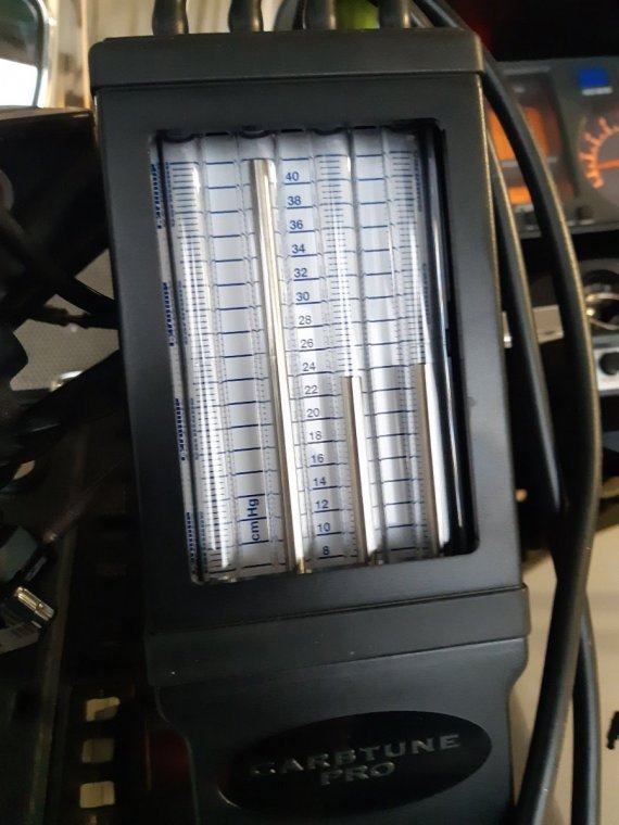

I believe the surface on the work table was flat, I remember using a torpedo level across the bodies to verify Does the reading from the sync test tell me that I have a serious vacuum leak? I guess meaning I have no vacuum at all on that cylinder unless my brand new meter is sticky, maybe I needed to play around with it more. Also there was fuel coming out of carb holders where I pluged sync hoes into

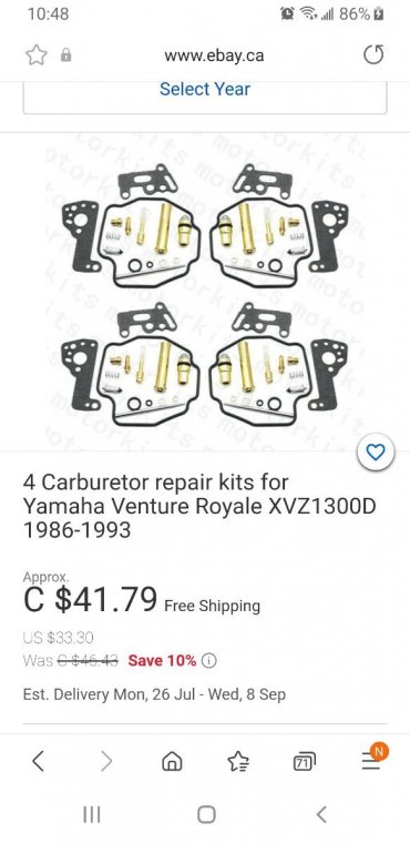

This was the kit I used, I re used the original float needle valves as when i put these ones in i had gas pouring out the overflow onto the ground. The carbs have been pulled out of bike about 5 times now so I've gotten it doen but not looking forward to doing it again lol
I did buy a carb rebuilt kit and used some new jets and gaskets which were probably cheaply made as I dont think I spent alot of money on it. So I blasted out all the passageways with carb cleaner, there is 1 air fuel mixture screw on cylinder 4 that is stripped and seized. I did compare the jets to old ones when replacing, I did also have the enricheners pulled part and replaced a gasket their from what I remember

Hey everyone, I am having some carb problems and wondering if I can get some pointers or lead in the right direction I have some gas-carbon splatter coming out the right side exhaust, spark plugs are dark and 1 was fouled, also noticed a drop of gas under exhaust from sitting. Next thing is I hooked up my new carb sync tool, and show nothing on cylinder 1, with 3 and 4 being relatively in sync as shown in my photo, to those with experience what does this mean? I am a newbie with this stuff but I'm afraid to keep running bike as I dont want to damage engine. My gas mileage is terrible, I get about 120km for 13 liters

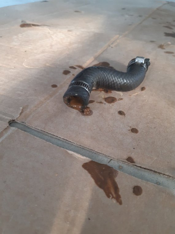

I had done a coolant flush when first getting bike, there was some of this crud in it, I never thought anything of it just figured that dexcool had been used and that was the issue, I am now wondering if it didnt all get flushed through originally, I did a compression check and have 142psi in rear cylinders 122 on the front, still have to do the wet test and see if it changes, seems low though compared to manual, so might be looking for a new bike, love this bike with only 500 km that I got to ride on it, just dont know how much to spend on it
Does this mean I have a blown head gasket? Basically looks like mud in the coolant, any advice, does this mean the bike is toast?
